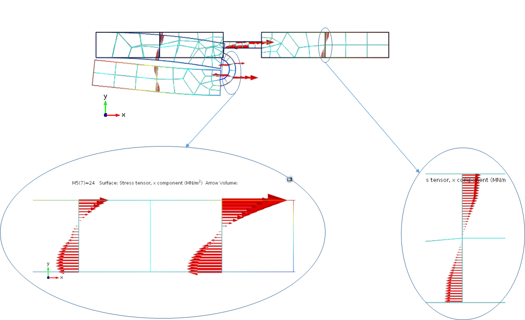

Hi Henrik,
I attached a photo where you can see the type of plots/diagram that I would like to generate.
Thanks in advance,
Jovana
Hi Henrik, I attached a photo where you can see the type of plots/diagram that I would like to generate. Thanks in advance, Jovana

Hi Jovana,
It seems like you want a Arrow Surface plot of the traction vector, (solid.Tax, solid.Tay, solid.Taz).
Henrik
Henrik Sönnerlind
COMSOL
Hi Jovana, It seems like you want a Arrow Surface plot of the traction vector, (solid.Tax, solid.Tay, solid.Taz). Regards, Henrik
