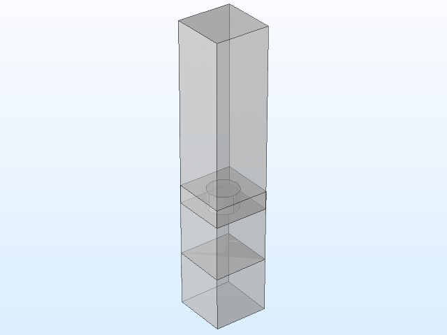

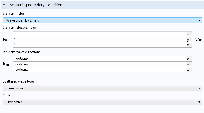

I am trying to obtain a transmission vs wavelength plot using Wave Optics Module and using the model shown in the attached image ("Structure"), which represents a unit cell of a photonic crystal. I send a wave using a scattering boundary condition at the top of the structure (whose parameters can be seen in the attached image "Scattering boundary conditions"). There is a block PML on the bottom of the structure and Floquet periodic boundary conditions all around.

Since the same problem is also shown in other COMSOL Forum's post and no reply was also given to it (before the discussion was closed), I will answer here how I managed to solve the problem.
Although it is definitely not the best method and it still requires some computational power and time, I verified the inputted power by removing the PhC from the model and simulating without it. Afterwards, I applied ewfd.nPoav to the same boundary condition to obtained the desired value.
