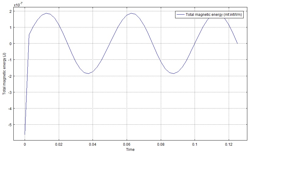

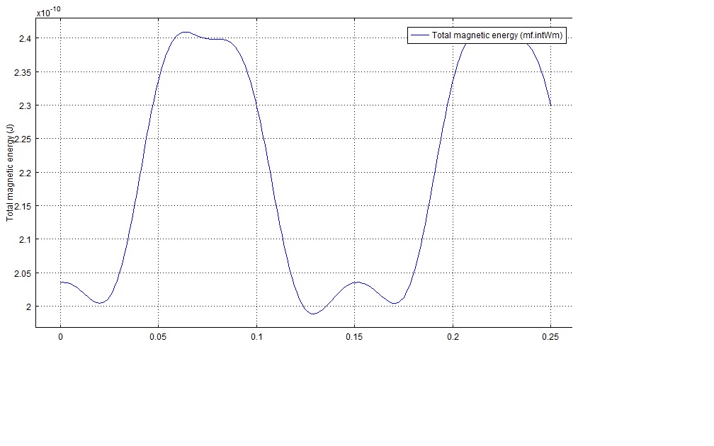

I am performing some simulations of a synchronous motor. Now I am dealing with cogging torque:
I'm using nonlinear material (Iron)
I checked the mesh to be symmetrical in the air gap, where I perform the stress tensor integration (I built a middle line in the air gap so as the mesh to be symmetrical: three stripes of element inner and outer it)
Then I integrate the magnetic energy in the rotor domains but what I get is a very irregular line (what I expect is a theta-derivative not higher than 0.01 Nm .. )
Could anybody help me?
