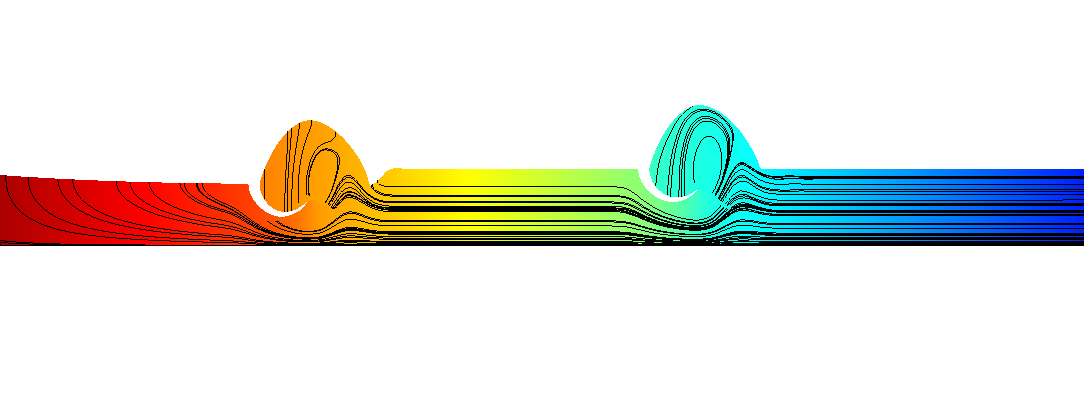

I attached some of my model pictures and the related behaviors of the fluids which is done in 3.5a

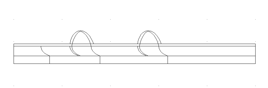

I added the fixed points in my geometry, these points are fixed, like fix the membrane to the tube. But still, error occurs!

Posted: 1 decade ago 13 avr. 2011, 06:47 UTC+2
I search the discuss forum and find that my interior boundaries like 3, 7, 11 .....need to be the continuity, and I do the ' form assembly' in the geometry node, so I should create 3, 7, 11, 12, 8 and all these interior boundaries as "identity pairs" and set them to be continuity, because other interior boundaries like 23, 38...these are the membrane interface holding u2, v2 boundaries!
but I don't know how to do it? When I try to use the pair----flow continuity----I can choose any boundary? Can you give me some suggestions?
About the inlet 2, I search the user's guide, I think the laminar flow physics is not active in the solid domain, so the interior boundary 11,20,23,27...serves as the exterior boundary of the fluid domain, so I can set it as inlet, did my understanding right?
I search the discuss forum and find that my interior boundaries like 3, 7, 11 .....need to be the continuity, and I do the ' form assembly' in the geometry node, so I should create 3, 7, 11, 12, 8 and all these interior boundaries as "identity pairs" and set them to be continuity, because other interior boundaries like 23, 38...these are the membrane interface holding u2, v2 boundaries! but I don't know how to do it? When I try to use the pair----flow continuity----I can choose any boundary? Can you give me some suggestions? About the inlet 2, I search the user's guide, I think the laminar flow physics is not active in the solid domain, so the interior boundary 11,20,23,27...serves as the exterior boundary of the fluid domain, so I can set it as inlet, did my understanding right?

I have several problems with your model, it might also be partly due to my newer release/patch.
I gave you one wrong hint, use rather for your velocity profile AND for the initial values velocity "x" component something like
u_max*(0.004-y[1/m])^2
Because of the symmetry boundary, you want maximum velocity there
By the way you are not respecting the units so this is also making life more difficult to check if it's coherent, it's worth to correct that
To get your example to run I need to :
- disable all the "weak constraints", disable your 4 "weak constraints", also the "inlet 2" and the symmetry nodes.
- Add a wall node with the same selection as the "symmetry", and select "SLIP"
then ONLY I can solve the SPF (alone) in a reasonable way
If I then add the structural and there:
- disable Prescribed displacement 2,3, as well as boundary loads 3, 5 and Point Load 1. And then replace the Boundary Load 4 values by the pressure "p" (from spf) and turn off the weak constraints in the prescribed displacements
- Normally I would replace your Prescribed Displacement 3 by "Fixed Boundary" but it's the same for COMSOL
The in ALE I'll leave as is
Then I can run and it gives some results for a stationary case (by adding a Parameter t = 0.1[sec] to force some flow, remove it when using the time stepping, even if COMSOL will automatically overwrite it when you add a time solver
If I replace the stationary solver by a transient one, then do not forget to change the "Time Dependent Solver 1 node "Time Stepping" from "Free" to "Intermediate" if you want to see your repeating pulses as otherwise it will jump over some and have convergence issues. And define enough steps to resolve the pulses (not too many 3-6 per pulse should do)
But I cannot get your model to run in transient yet.
I believe its easier to reconstruct it, by exporting the geometry and reimporting it into a fresh v4 model, I suspect translation issues, or just that the model has been modified too many times ;)
I agree my comments are somewhat messy. It would be easier to restart and add one physics at the time, solve for it and check that its running, using SPF, ALE and then Solid.
