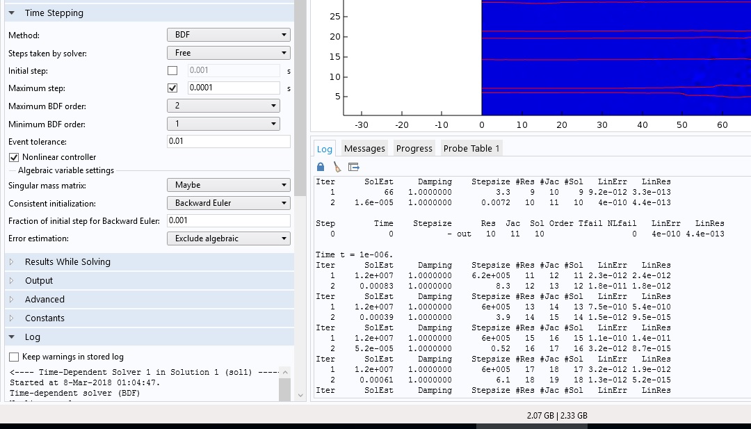

Regarding time stepping. The behaviour of the solver is somewhat confusing. You can see in the attached screen grab that I set the max timestep to be 0.0001, but in the log file, the solver is testing stepsizes such as 6.2e+5. The units in the log file are not seconds ?
Thank you for your insights. Switching off turbulence stabilization does seem to help Regarding time stepping. The behaviour of the solver is somewhat confusing. You can see in the attached screen grab that I set the max timestep to be 0.0001, but in the log file, the solver is testing stepsizes such as 6.2e+5. The units in the log file are not seconds ?
Stepsize is not a time step. It is an internal measure of the increment of the degrees of freedom in one iteration in the nonlinear solver (within the current time step).
