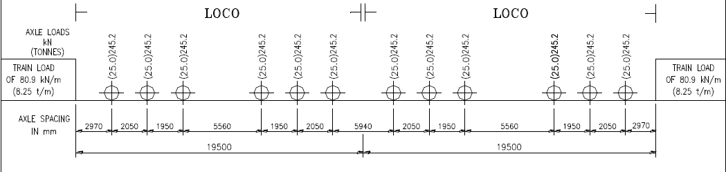

I am not getting what does the train load(80.9kN/m) represents in the train load diagram. Can someone help me in understanding the loading diagram which I have attached here so that i can do a better job in modelling the load.
Regards, Varsha
