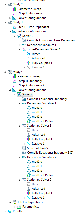

Posted: 1 decade ago 11 sept. 2012, 01:15 UTC+2
Hi All,
I have almost the same problem but a bot different as first I computed a stationary parametric sweep for my fluid flow in the pipes as it does not change with time and then will use the results for my second study which is time dependent for the heat transfer. but apparently when i check the results from the second study, has not considered the parametric sweep from the first study.
Hi All, I have almost the same problem but a bot different as first I computed a stationary parametric sweep for my fluid flow in the pipes as it does not change with time and then will use the results for my second study which is time dependent for the heat transfer. but apparently when i check the results from the second study, has not considered the parametric sweep from the first study.
Posted: 1 decade ago 11 sept. 2012, 01:22 UTC+2
Hi All,
I have almost the same problem but a bit different as first I computed a stationary parametric sweep for my fluid flow in the pipes as it does not change with time and then will use the results for my second study which is time dependent for the heat transfer. but apparently when i check the results from the second study, has not considered the parametric sweep from the first study.
Hi All, I have almost the same problem but a bit different as first I computed a stationary parametric sweep for my fluid flow in the pipes as it does not change with time and then will use the results for my second study which is time dependent for the heat transfer. but apparently when i check the results from the second study, has not considered the parametric sweep from the first study.
Posted: 1 decade ago 11 sept. 2012, 20:49 UTC+2
When you have two solvers in sequences, you need to "store" the output of the first and get the second initials condition's node to read the stored results.
Often COMSOL takes care of htis, but if you have changed the solvers in any way from the COMSOL defaults, then COMSOL assumes you are taking care of lal changes, and you must manually check that this is done, by adding if requred a" store node" and setting the pointers of the node fields to the desired solutions data sets. (Or you clear the solvers, and your postprocesing, and generate a COMSOL default solver settings fresh again, then in general the links are set-up OK by COMSOL
Hi When you have two solvers in sequences, you need to "store" the output of the first and get the second initials condition's node to read the stored results. Often COMSOL takes care of htis, but if you have changed the solvers in any way from the COMSOL defaults, then COMSOL assumes you are taking care of lal changes, and you must manually check that this is done, by adding if requred a" store node" and setting the pointers of the node fields to the desired solutions data sets. (Or you clear the solvers, and your postprocesing, and generate a COMSOL default solver settings fresh again, then in general the links are set-up OK by COMSOL -- Good luck Ivar
Posted: 1 decade ago 13 sept. 2012, 02:51 UTC+2
Hi Ivar,
I do exactly the same as you mentioned. my first study is stationary and parametric sweep (velocity) only for the fluid flow and I store solutions and use the solutions as initial conditions for my second study which is transient and only for heat transfer but it looks like parametric sweep does not work.
I have also attached the mph file and would appreciate if you please comment on that.
thanks
ASAL
Hi Ivar, I do exactly the same as you mentioned. my first study is stationary and parametric sweep (velocity) only for the fluid flow and I store solutions and use the solutions as initial conditions for my second study which is transient and only for heat transfer but it looks like parametric sweep does not work. I have also attached the mph file and would appreciate if you please comment on that. thanks ASAL
Posted: 1 decade ago 17 sept. 2012, 03:44 UTC+2
Hi Ivar,
thanks
ASAL
[QUOTE] Hi Ivar, I do exactly the same as you mentioned. my first study is stationary and parametric sweep (velocity) only for the fluid flow and I store solutions and use the solutions as initial conditions for my second study which is transient and only for heat transfer but it looks like parametric sweep does not work. I have also attached the mph file and would appreciate if you please comment on that. thanks ASAL [/QUOTE]
Posted: 1 decade ago 19 sept. 2012, 08:16 UTC+2
first a few comments,
1) your HT fluid region you can select Velocity field "spf/fp1" instead of user defined, not that it should changee anything the way you have done it
2) your study 3 stationary, in the "Values of dependent variables" you shoul select it and refer to the first study, then you do not need to go into the details of all the dependent variables of study 3
3) as you ahve a parametric study in case 1, and just a time series, I do not beleive COMSOl proposes to do a mix, but will take only the first result from study 1, two ways around : 1) add a parametric for study 3 and hope COMSOl understands (I havent checked if this is truely the case, just a guess, 2) my preferrenec, set up one new study with the parametric sweep frist, then two stationary solver in sequence under the same "study", one after the other, the frist for the fluid, the second for HT. COMSOl will then make a "store solution to transfer the dependent variables not solved for from one to the next case
then generate the default solvers, you should get something like this (see image)
Hi first a few comments, 1) your HT fluid region you can select Velocity field "spf/fp1" instead of user defined, not that it should changee anything the way you have done it 2) your study 3 stationary, in the "Values of dependent variables" you shoul select it and refer to the first study, then you do not need to go into the details of all the dependent variables of study 3 3) as you ahve a parametric study in case 1, and just a time series, I do not beleive COMSOl proposes to do a mix, but will take only the first result from study 1, two ways around : 1) add a parametric for study 3 and hope COMSOl understands (I havent checked if this is truely the case, just a guess, 2) my preferrenec, set up one new study with the parametric sweep frist, then two stationary solver in sequence under the same "study", one after the other, the frist for the fluid, the second for HT. COMSOl will then make a "store solution to transfer the dependent variables not solved for from one to the next case then generate the default solvers, you should get something like this (see image) -- Good luck Ivar
