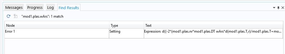

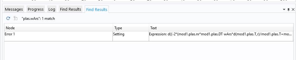

Hi Dear Henrik, Thanks for your answer. But it did not help! I searched some definion but find just in error code! *Please see attached screenshots.
Saluti
Hi Dear Henrik, Thanks for your answer. But it did not help! I searched some definion but find just in error code! *Please see attached screenshots. Saluti

Did you have "Equation View" turned on in the Show button ("eye" icon at the top of the Model Builder) when you ran that search?
Did you have "Equation View" turned on in the Show button ("eye" icon at the top of the Model Builder) when you ran that search? Jeff
Posted: 7 years ago 21 mars 2018, 23:43 UTC+1
Dear Jeff, yes! turned on! but still search does not yield any results!
