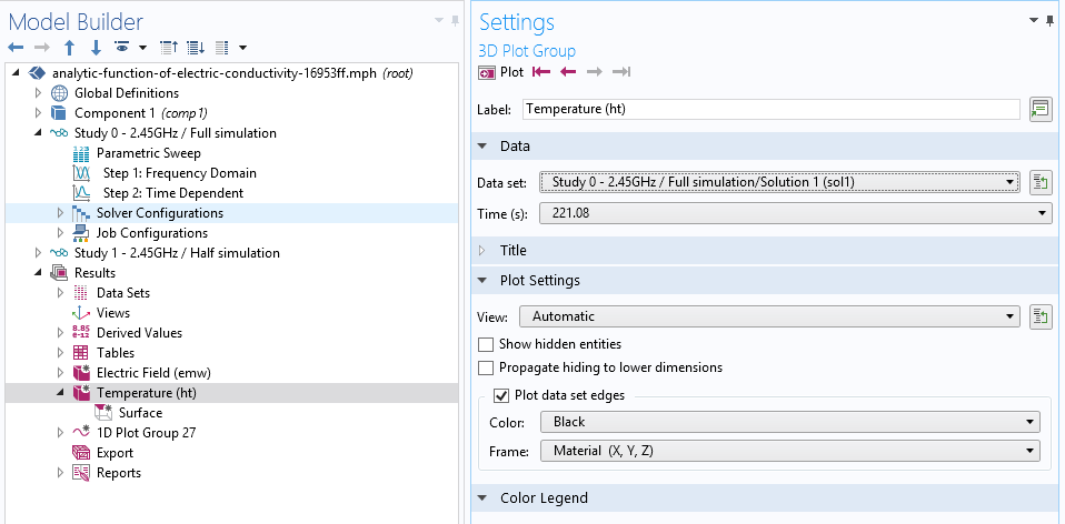

Dear Sungwoo,
I see, you need to make sure that the temperature plot refers to the solution you are computing (sol1 here) as shown on attached screenshot temperature_plot.PNG. Then in the Graphics tab I get the temperature plot (see plot_while_solving.PNG).
Nicolas
Dear Nicolas,
Thanks for the screenshot. Now I know what I should look. I was expecting to see a new plot graph window appears, and that's why I couldn't see the 'Result while solving' is working. ;)

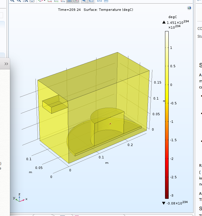

I've monitored what happens while solving the model, and have found interesting things. The temperature sparks occasionally with below cases.
- Material is getting really hot with a hotspot - up to 4.056E81 x1.0E81 degC.
- The air domain is getting extremely hot - up to 3.456E250 x 1.0E250 degC. In this case, the hotspot in the material becomes coolest point. The temperature of the hotspot is minus here (see the screenshot).
- When the time reaches 209 seconds, the convergence value continuously grow as high as 2.6E12, then stop with a singularity error.
I've test a simple swept mesh with the material but it only increase the computation time and get the same error. I will try more options for swept now.
BTW, I see you are using the full simulation model but I use the half simulation model. I believe that there shouldn't be any differences between them.
Warm regards, Sungwoo
