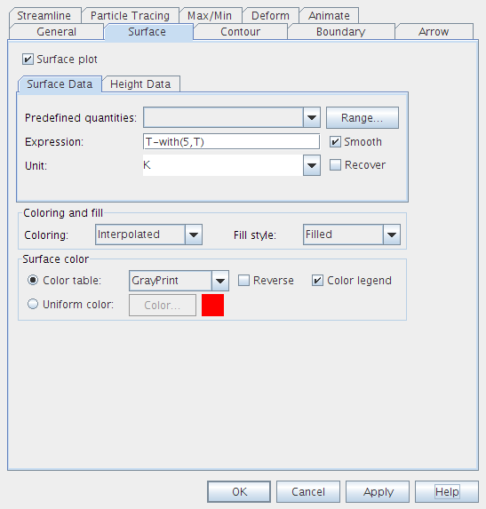

How would I go about producing a surface plot of differences in temperature?
If I create a surface plot of temperature (via: Plot Parameters > Surface, and select Temperature in the 'Predefined uantities' drop-down) for solution 1, and then do the same for solution x (e.g. solution 5), I see a significant difference. How can I use those surface plots to create a 'difference surface' plot? So that at every point on the surface, the displayed T is T(5) - T(1)?

Indeed, if its the difference, point by point over an edge or area, between two "solver steps" there are also the "at()" and "with()" operators
Great!
Thank you Jean-Francois, I used the following in the Plot Parameters dialogue box, 'Surface' tab, Expression field:
T-with(5,T)
and got something like what I was expecting.
