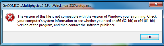

Recently I changed my Operating System to Windows 7(32 bit) . The comsol software is not getting installed. What could be the reason. It gives some error message as shown in the image!! Please help me guys.........

The error message is pointing out that the version of COMSOL you are trying to install (5.3) does not support your 32-bit OS. You will need to install a supported OS, such as a 64-bit version of Windows, or if you have to use a 32-bit version of Windows revert to an older version of COMSOL (The last one to have supported 32-bit Windows was 5.1).
For detailed system requirements for various versions of COMSOL, see https://www.comsol.com/system-requirements/
