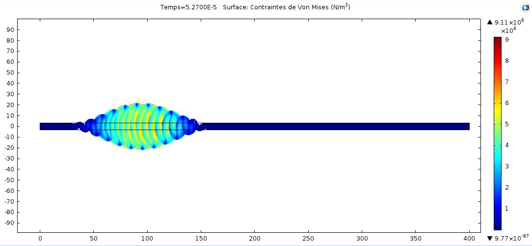

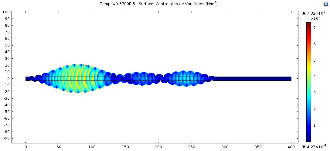

Hi, I am working on lamb wave propagation in steel plate. I am using comsol 5. In attachments you find the propagation of A0 lamb mode in plate with symmetric internal rectangular defect. After the interaction of lamb wave with defect, a part of the wave is reflected, the second part is transmitted. As the defect is symmetric, normally there will not be a conversion, however in my simulation I have got two waves transmitted. I want you to guide me to correct my model. I
