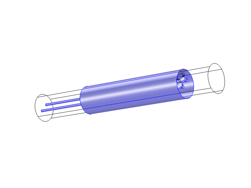

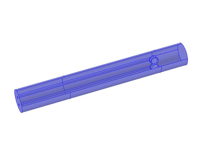

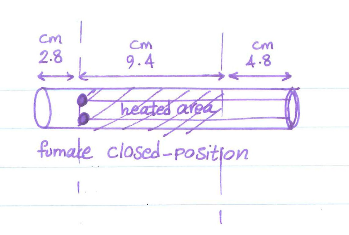

I model a furnace. It is a tube. A part of this tube's wall is the heated area of the furnace. The temperature of inside of the tube reads 900 C, so that the heat transfer mechanism from tube's internal wall to all components inside the tube (two beams and cups) is radiation.
For this modeling, I am using Conjugate Heat Transfer module (because inside the tube there is a laminar air flow passing, and I am interested in both velocity and temperature profiles inside the furnace).
In order to include radiation heat transfer from tube's wall to tube's internal parts, should I add a surface cylinder to my geometry then say the radiation is from this surface to .... (but in this way no material I could add to this surface [to be able to count for view factor and so ...]), or I should make two solid cylinder and substract them from each other to make a shell then it is possible to add material of construction to this wall, or even none of above mentioned ways but just work with workplace ?
I attached my geometry for better understanding here.
I really appreciate any kind help.
