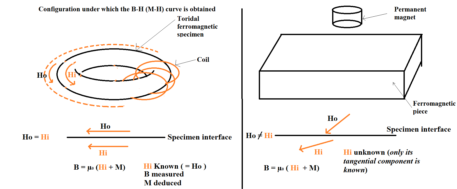

                                                    Hello Edgar,
It isn't possible to use the B-H curve if one doesn't know the H field inside the material.
The B-H field is a obtained in the case where we know the H field inside the material, and this by making its direction tangential to the surface of the material and its value uniform along the specimen, in the attached picture I try to explain that.
The use of "closed" specimen forms, helps us avoid the discotinuity of the normal component of the H field at the boundaries.
The B-H curve becomes usuful when one knows the H field inside the material.
Once again I thank you for your rapid replys, and I hope COMSOL can provide what we are looking for (The magnetic field density H inside a ferromagnetic material)

                            Hello Edgar,
*The use of "closed" specimen forms, helps us avoid the discotinuity of the normal component of the H field at the boundaries.*
Best regards
                                Edgar J. Kaiser
                                                                                                                                                    Certified Consultant
                                                Posted:
                                7 years ago
                                29 mai 2018, 09:06 UTC−4
                                                    Comsol solves for the magnetic scalar potential Vm or the magnetic vector potential A and the nonlinear material model is respected by the solver. The magnetic field H is made available as the gradient of Vm or the curl of A.
