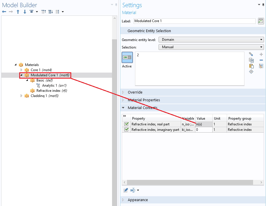

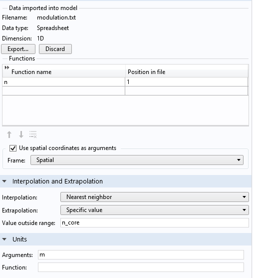

as already mentioned in the attached forum discussion, it is possible to use spatial coordinates as arguments. I have used the same approach as shown in the first picture. The defined function (called n) is then used to define the refractive index of some part of the model geometry. This is shown in the second picture. Upon hitting the Build All-Button to generate the mesh I get the error message shown in the third picture.

(1) Is the used process to define a space dependent material property right?
(2) Which coordinate is choosen by COMSOL to be the argument for the interpolation function? In the plot COMSOL displays x. From that, can I conclude that COMSOL is using the coordinates along the x-axis as argument?
