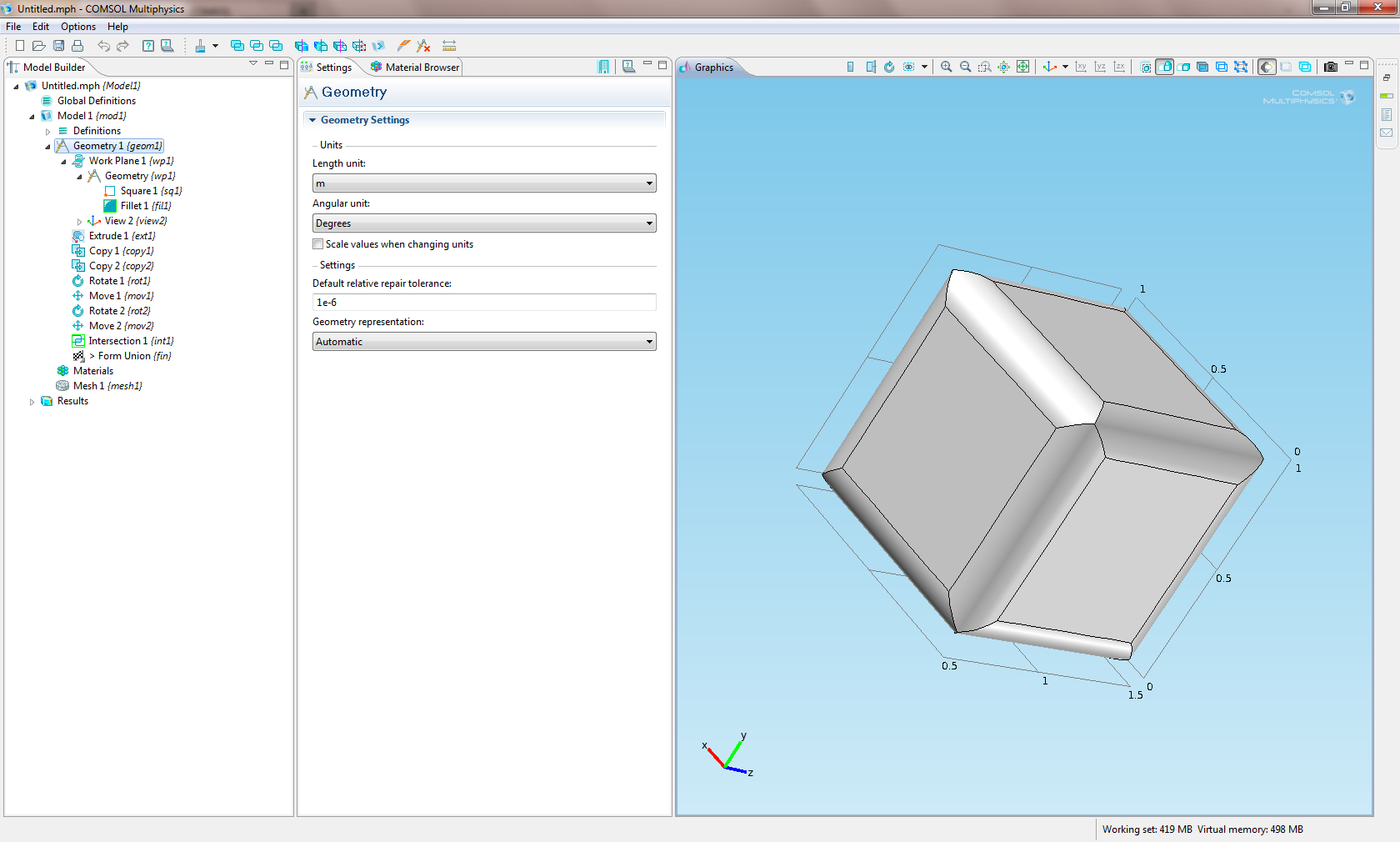

If you are trying to fillet the edges (not just round the vertices) of your cube, you can achieve that by filleting a square in a workplane, extruding that, making two copies of that extruded object, moving and rotating them appropriately and taking the intersection of those three objects, see the attached screen shot.

There's nothing to it, really. In a workplane you just create a square and fillet its corners. Then you extrude that shape; that gives you a square column with rounded edges. You make two copies and rotate them 90 degrees so that the three columns are aligned with the x,y, and z axes. Finally you move them so their intersection is the dice you are after, and take the intersection.
If you update to 4.1 I can send you the mph file.
There's nothing to it, really. In a workplane you just create a square and fillet its corners. Then you extrude that shape; that gives you a square column with rounded edges. You make two copies and rotate them 90 degrees so that the three columns are aligned with the x,y, and z axes. Finally you move them so their intersection is the dice you are after, and take the intersection. If you update to 4.1 I can send you the mph file.

follow the steps under the model builder geoemtry tab, of the dice.png picture, and you will find out ;)
Hi follow the steps under the model builder geoemtry tab, of the dice.png picture, and you will find out ;) -- Good luck Ivar
