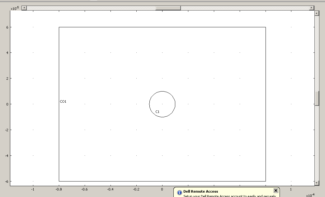

As blood in my model flows in the direction coming out from the page (screen) ,as you can see in the image I’ve attached in my previous post, I’m not sure x or y direction are suitable… what direction can I model than?

My model is 160 ,icron in length, 120 micron un height and I’ve defined a thickness of 150 micron…

I must say I was rather disappointed to read in your reply that “, water as a fluid canot be modelled correctly with the structural application” and that I need Navier-Stokes application… I don’t want to use Navier-Stokes application because I don’t want to define blood velocity… I thought that by using the model library I can select a material that will fit well with the modulu I am currently using…
Well, indeed at first I’ve modeled my capillaries (which are in the diameter of 10 microns) as a hole in the tissue, and applies a load on the boundary to represent blood pressure. I must add that I’m applying displacement on the upper boundary of my muscle (upper boundary of the rectangle) , as I want to see the deformation. At first I’m modeling a displacement in the x direction; the next step will be to add a y displacement also.
The reason I wanted to add a material to the capillary “hole” was:
1. I thought this will be more exact, then I could also see the stress distribution in the capillary subdomain.
2. as I am coupling the bioheat modulo as well, solving for the thermal map I get the temperature in the muscle, but the capillary still appear as a hole.
However, those matters are not critical issues, just thought it will be nice to have… ?
I know that blood (or water) is not a hyperelastic material (blood is viscoelastic). But after I’ve added water from the fluid material library (I have done the 1a-1d steps you suggested, properties defined in the library for water as liquid are: heat capacity, dynamic and kinematic viscosity, density and thermal conductivity, clicking on the “function” button I have seen that the properties are dependant on temperature and they fit my model) I’ve noticed that the subdomain settings for the material model weren’t changed (besides the density which was taken from the model library and appeared in bold), the material was selected by comsol as default as isotropic with default values of E, etc… as were already in there before the loading of water material from the library… this is why I thought of changing those values and settings…
Well, I guess that if I need to add the Navier-Stokes application, I’ll better leave my capillaries as holes and use the structural modulo alone…
Yael.
Well then I hadnt forgotten everything, good.
Now were I do not agree is when you propose:
"1. I thought this will be more exact"
Using physics on a boundary is not "less exact", provided that your physics is correct and describe all (most)properties involved.
An incompressible liquid as water has no shape, hence whatever is applied on one wall containing some water is distributed uniformly on the others, your vessel section will not change except due to the thermal expansion difference of water from a temperature change, but for a body these temperature changes are minime and the thermal expansion of water is small.
At least for me pressure on the wall is plenty to describe what happens in the blood vessel in 2D.
Once you go further into the details, one would need a better 3D model with the fluid and its velocity along Z, then the visuosity of the blood would also be needed, and normally the velocity distribution of the fluid in the vessel, which is not uniform, rather parabolic with about 0 velocity strictly on the borders.
This means on the other hand that the formula for h=rho*C*v is supposing a perfect heat transfer wall-liquide and is a "best" case.
The corrective factor for "h" would also depend somewhat on the vessel diameter, the heat conduction and the transverse velocity of the liquide (still neglecting turbulence), as if the conduction is high, the transverse velocity low and the diameter small, the temperature gradient across the liquide can be neglected, and we have a better heat transfer from wall to liquide.
A radial scaling value "a" can be obtained from:
a[m]=k[W/m/K] / (Cp[J/kg/K] * rho[kg/m^3] * vz[m/s])
where k is the heat conduction, Cp the heat capacity, rho the density and vz the transverse velocity of the liquide
Finally, the bioheat equation is basically considering all this by assuming an uniform capillary density for a given volume of body material.
Further, when you go one step further into the details, one would see Venturi effects from the blood flow and its pressure variations of the hart beats, fighting against capilary collaps, but for this I believe you need a 3D model, and such 3D models are very heavy: hours to solve and dozens of GB RAM required.
One way out would perhaps be to push further 3D flow physics on the 2D edge boundary.
In conclusion quite some physics from many domain to apply, true "multi-physics" here
Have fun
PS from next week on I'm back at work, so I will have far less time to follow the forum
Guess I better stick to 2D with the load on the capillary boundaries… :)
Thank you again for your help, I appreciate it so much.
Hope you are enjoining your time away from work,
Happy New Year,
Yael
