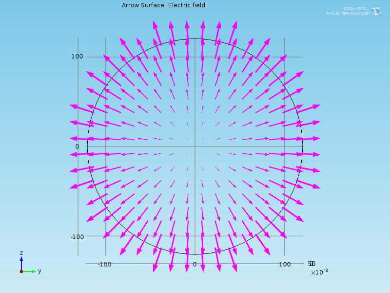

[start here] Hello, I would like to generate a radially polarized source in RF module in such a way that the electric field contains radially orinted vectors and have a hole on the symetry axis. anyine has an idea how can I write the distribution function for the x & y components of E, as functions of (x,y). Any suggestion would be appriciated. Warm regards

  2. You can create a circular waveguide port in Comsol Multiphysics and set the port to be driven by a TM01 mode. That will immediately give you a local spatial distribution in a waveguide, with the properties you asked for. If you would like to see the mathematical expressions for a circular TM01 mode, look in any good textbook on EM. And if you want your distribution to exist/propagate outside a waveguide, you can always radiate it from your circular waveguide, with or without first flaring it into a circular horn.

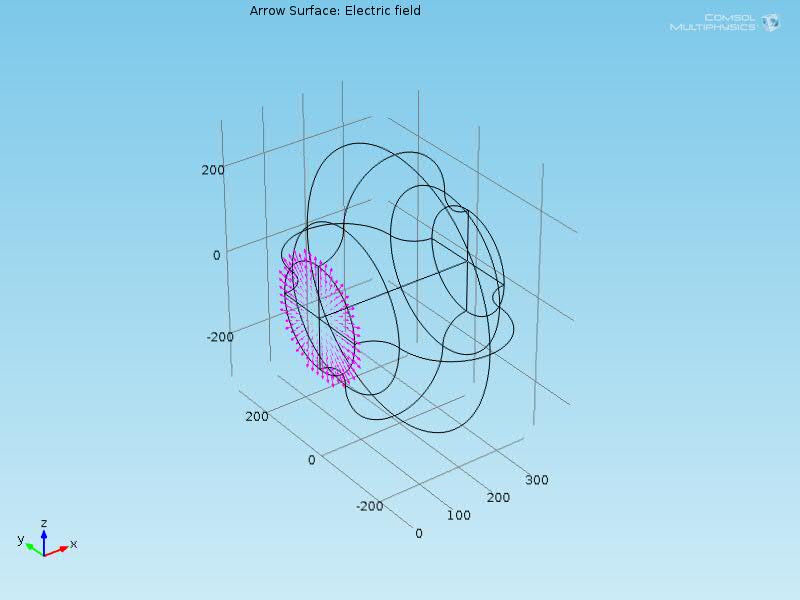

Hello Robert Koslover Thank you very much for your nice explanation. I still have dificulty come up with my expressions for input electric field. I have a cavity which is not a cylinder ( please see attached images) . I would like to create a THz source in RF Module in such a way that the electric field of the incident THz wave contanies radially orinted vectors and have a hole on the symetry axis and the wave propagates along x direction. I have already been trying it for 3 weeks and still couldn't find any solution. I use COMSOL 4.3 and this version does not contains circular port. (only rectangular port). I am intrested radiating spatial distributon not for comunication purposes. I apreciate any idea and thank you in advance for your time and considerartion Kind regards Mozhgan

I don't recall the limitations of version 4.3. You could still define a circular TM01 mode mathematically, I presume, so I would recommend that.
If not, consider this alternative work-around: Create a smoothly tapered rectangular (or square) to circular, straight transition section. Connect the circular end to drive your cavity. Drive the square end with a TM11 rectangular mode (I'm assuming the code allows you to specify that). This works, because the TM11 rectangular mode is the rectangular-analog to the circular TM01 mode, so a sufficiently smooth/gradual straight transition will yield a clean circular TM01 mode at the circular end.
