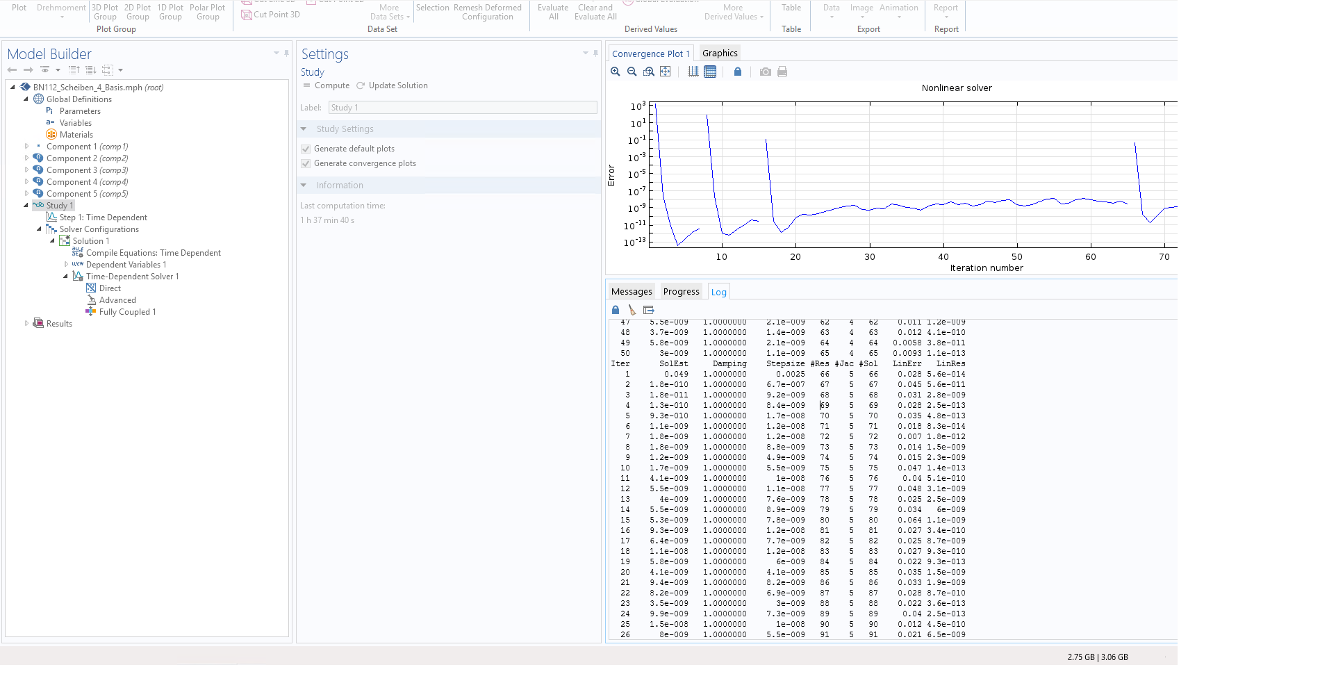

                                                    Hi Jan,
This indicates that the system matrix is ill-conditioned. There can be many underlying reasons, ranging from the actual physical properties of the problem you are solving to erroneous boundary conditions or material properties.
If the solver for the 'innermost' problem (the linear solver) in your iterations reports this kind of problem, the 'outer' nonlinear solver will not accept the solution as converged, even though its own criteria are fulfilled.
You can force the nonlinear solver to accept the solutions nevertheless. Change the settings in the 'Error' section in the 'Direct' node in the solver sequence. This is usually safe in a nonlinear problem, since a 'bad' solution will give extra iterations. Your graph indicates that there are no large residuals, so suppressing the check on the solution from the linear solver seems OK.
Henrik
    Henrik Sönnerlind
COMSOL
                            Hi Jan,
Henrik

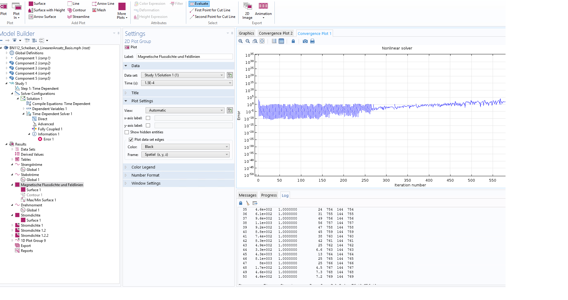

                                                Posted:
                                7 years ago
                                5 juil. 2018, 07:25 UTC−4
                                                    Hi again,
I tried Henriks tip with the Error check and the model does solve for a few time steps now (see the attached plot of the Convergence). Unfortunately, after some succesfull time steps, the nonlinear solver fails to converge.
I checked if the dependent variables show questionable behaviour. They look very smooth and not suspicious. From my point of view, the results look physically correct, but the solver says otherwise...
Kind regards,
Jan
                            Hi again,
