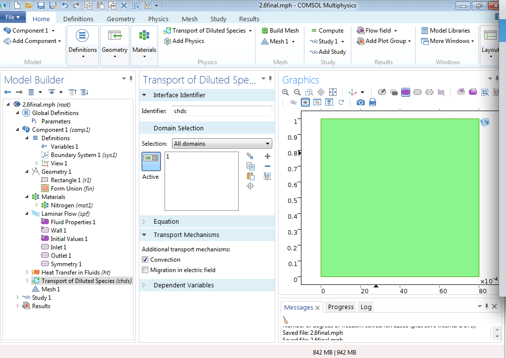

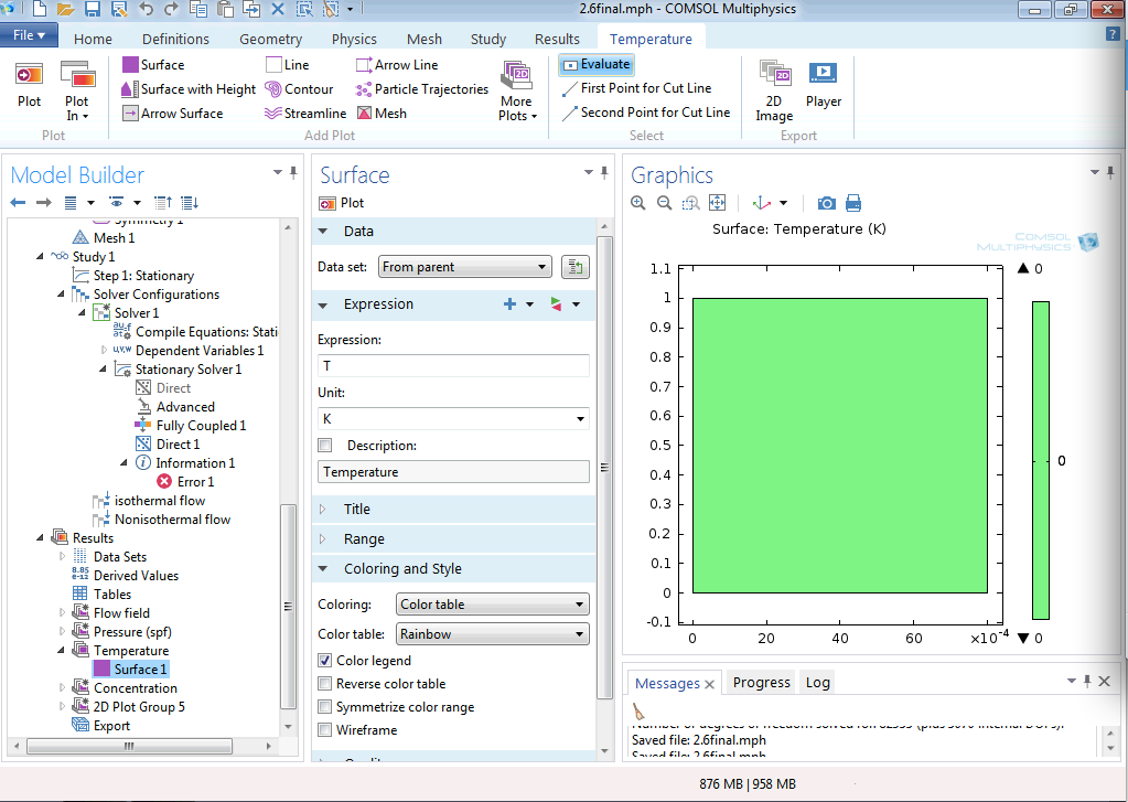

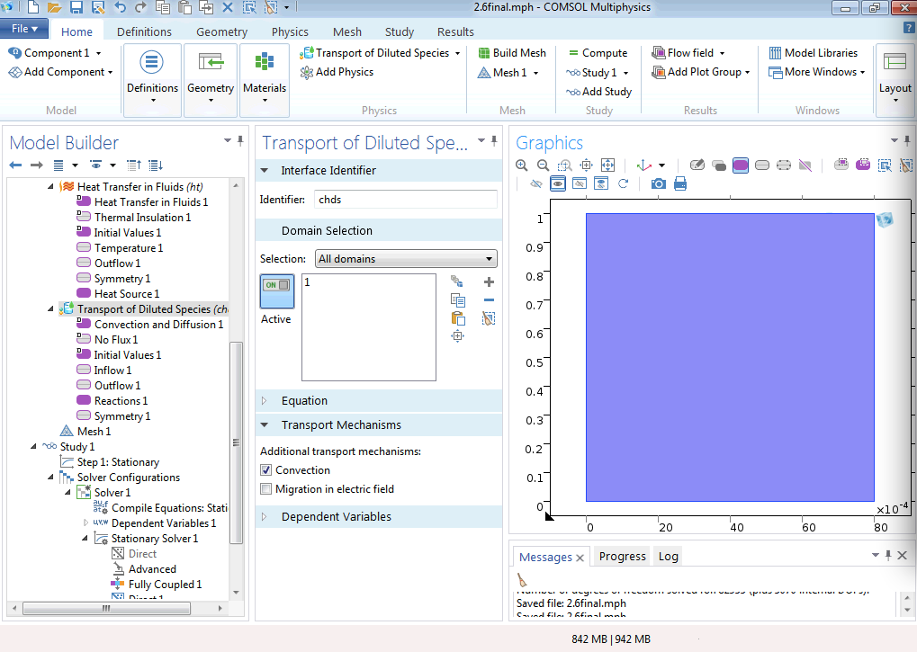

Posted: 1 decade ago 6 févr. 2015, 02:06 UTC−5
Hi Ivar,
I saw you helped so many people. Thanks for your generous help. And could you help me with this premixed laminar combustion of hydrogen in a 2-D symmetric cylinder ?
I am using COMSOL to simulate steady state premixed laminar combustion of hydrogen (all mixture can be considered as ideal gas)in a cylinder with specific diameter to get the space dependent temperature and concentration distribution. So I coupled the laminar flow, heat transfer in flows and transport in diluted species(I am not sure whether it is proper to use this module for mass transport , to make it more reasonable, I assume the reactants ,i.e. the hydrogen and the oxygen are dissolved in nitrogen). But then I encountered the problem “Undefined value found in the equation residual vector”. I tried the methods you mentioned here but it seems they do not work. Could you help me with this?
I really appreciate your kind help.
Kate
Hi Ivar, I saw you helped so many people. Thanks for your generous help. And could you help me with this premixed laminar combustion of hydrogen in a 2-D symmetric cylinder ? I am using COMSOL to simulate steady state premixed laminar combustion of hydrogen (all mixture can be considered as ideal gas)in a cylinder with specific diameter to get the space dependent temperature and concentration distribution. So I coupled the laminar flow, heat transfer in flows and transport in diluted species(I am not sure whether it is proper to use this module for mass transport , to make it more reasonable, I assume the reactants ,i.e. the hydrogen and the oxygen are dissolved in nitrogen). But then I encountered the problem “Undefined value found in the equation residual vector”. I tried the methods you mentioned here but it seems they do not work. Could you help me with this? I really appreciate your kind help. Best, Kate

Posted: 1 decade ago 2 avr. 2015, 09:55 UTC−4
Hi, so you also work on combustion problem? I used the PARDISO solver for the steady-state simulation. so you mean this information? How should I change it?
Thanks for your help, Kaiwen.
Hi, so you also work on combustion problem? I used the PARDISO solver for the steady-state simulation. so you mean this information? How should I change it? Thanks for your help, Kaiwen.
