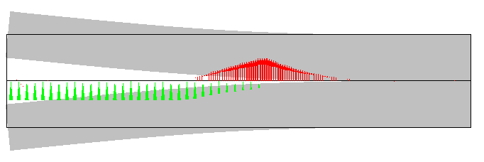

Hi Stefan,
I have uploaded a simple 2D model (version 4.3b) illustrating the principles of how a cohesive zone can be modeled in COMSOL Multiphysics. The model is not solved, but it only takes a minute or so to do it (and the animation during solving is nice).
Important features are:
- The expression in the thin elastic layer and the constitutive function it references.
- The extra weak expressions added for keeping track of the maximum opening experienced in a certain point. This is not necessary in a case where there is no unloading but then the constitutive relation would have to be written in a different (simpler) way too.
- The setup of the solver steps.
The uploaded plot shows the stress distribution (red) and a damage parameter (green).
The model is run under prescribed displacement. The reaction force plot shows why this is necessary. The released energy during cracking/delamination is so large that it would be unstable under a prescribed load.
Henrik

The table graph of the applied force points to Table 1.
Table 1 is generated by the Line Integration node under Derived Values. That integration sums the reaction forces on the boundary where the displacements are prescribed, which is the applied load.

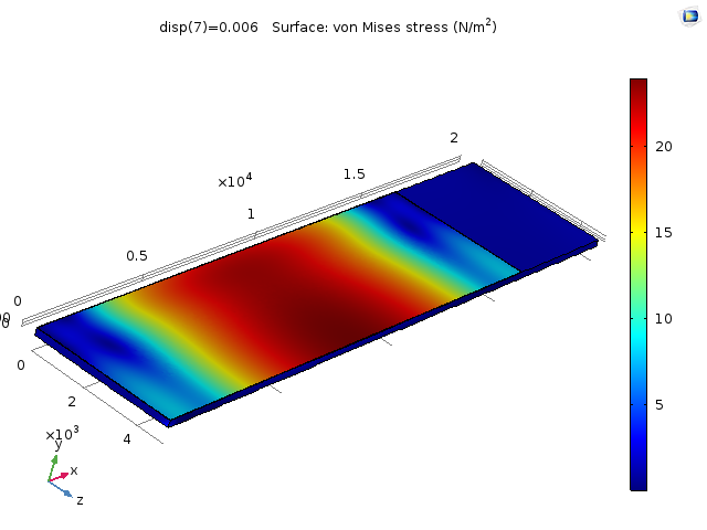

Hello Henrik.
How do I model decohesion due to moisture (drying effect).
I've worked on my model but the problem comes in defining a global equation to convert the hygroscopic forces into a displacement.
In this case I get stresses on the hyroscopic layer but there is no debonding.
Thank you.
