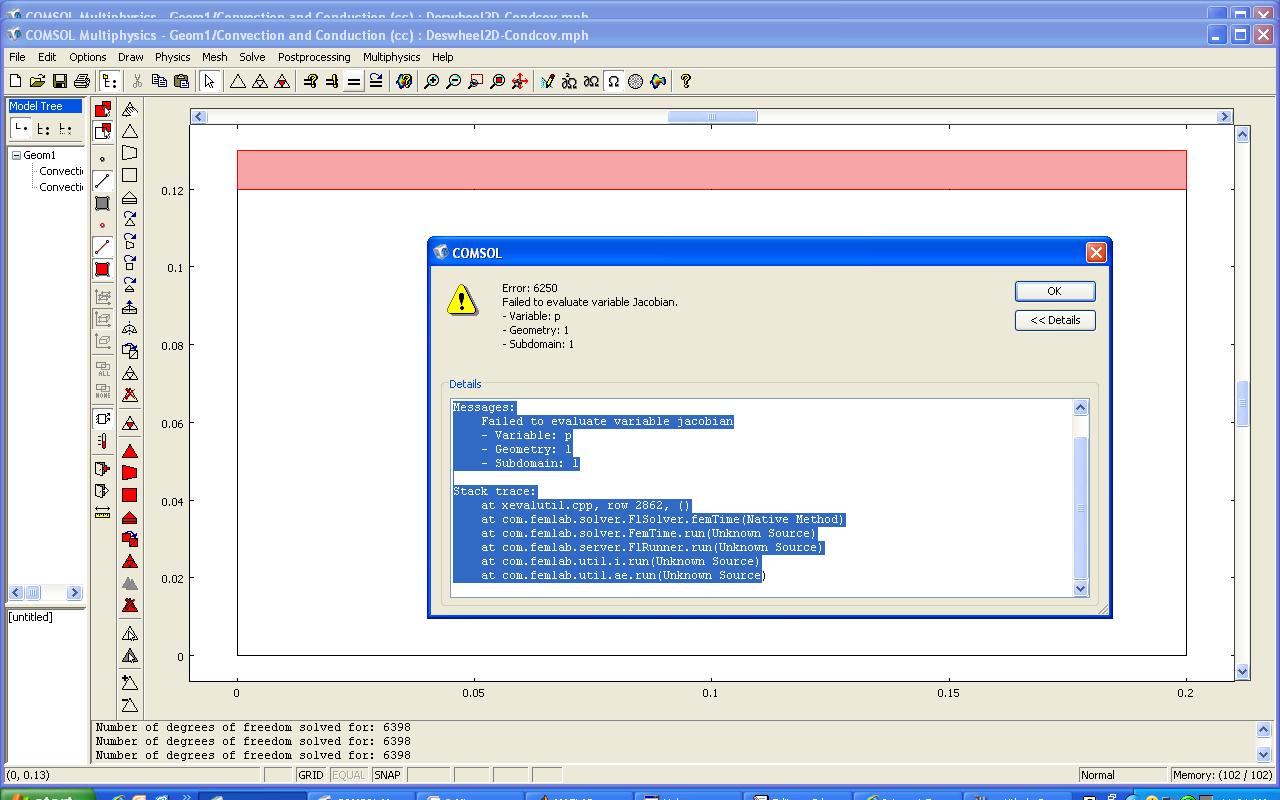

Hi,Niklas,
Thanks for the clue. I checked the 'Show details'. It is in the attched file. It is not clear which is the problem function. Could you have a look at it
Regards
Ramadas
Hi,Niklas, Thanks for the clue. I checked the 'Show details'. It is in the attched file. It is not clear which is the problem function. Could you have a look at it Regards Ramadas

Hi Ivar,
Thanks for reply. To tell more about the problem, I have attached the model file.It has 2 subdomins, 1 with convection and conduction , other with convection and diffussion. There is no parameter denoted with p. It shows error with p.
Thanking you once again
Ramadas
Hi Ivar, Thanks for reply. To tell more about the problem, I have attached the model file.It has 2 subdomins, 1 with convection and conduction , other with convection and diffussion. There is no parameter denoted with p. It shows error with p. Thanking you once again Ramadas
