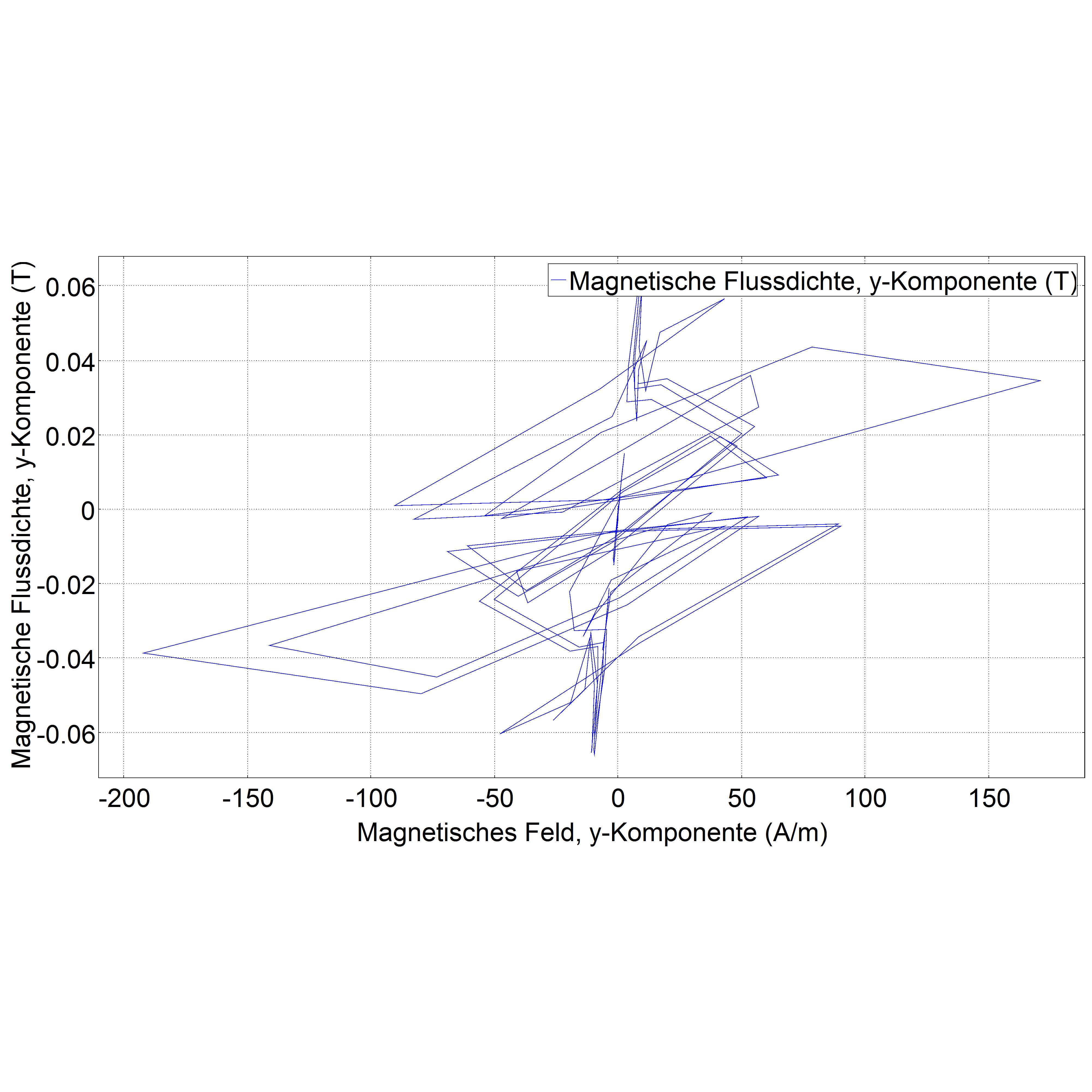

i desperately try to evaluating hysteresis loss in comsol way. there are a few commonly used formulas.
i think, the easiest is to measure the area enclosed by the hysteresis loop in a cycle Ahyst
Ph= f * integral [ H * dB ] --> but how about sekundare Loop ? see the attachment (hysteresis on the stator tooth)
there are two most common models Jiles-Atherton (JA) and Preisach model (PM)
to use JA parameters alpha, M, a, k and c should be identified for example bei conduct an experiment
PM is mathematical model of hystereses (very mathematic). i have difficulty to understand it and implement it in comsol.

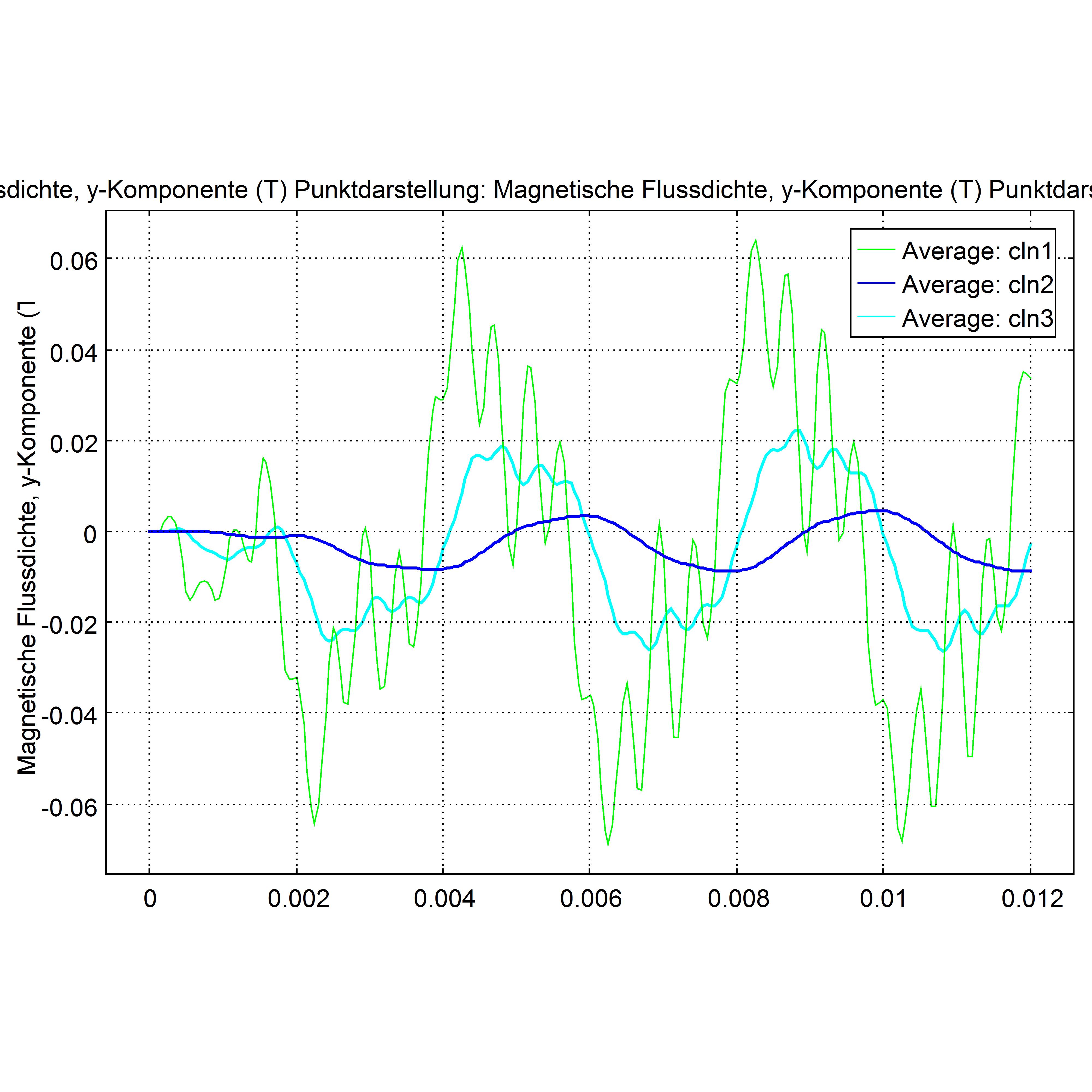

-Steinmetz-Model (SM)
Phy/V = k * f^alpha * B^ß
this SM is more for pure periodich flux. k and ß can be calculate using PM. see B-curve (green line)
I have non-lin HB-Curve of the Softiron.
What is the best (accuracy, simple) way to evaluate hysteresis loss?

Hi All,
i got the curve of one periode of magnetizing in B vs H.
The BH Area could be caculated in primitiv way. comsol has rmm.Wm calculated. by using photoshop i can evaluate the relation (c=Ahyst/Amax) between closed loop area and the maximal area of B*H (instead of rmm.Wm).
Whyst [J/m³] = c * Wmax
Physt [W]= Whys * freq * Volume
any comments are welcome.
regards
akmal
