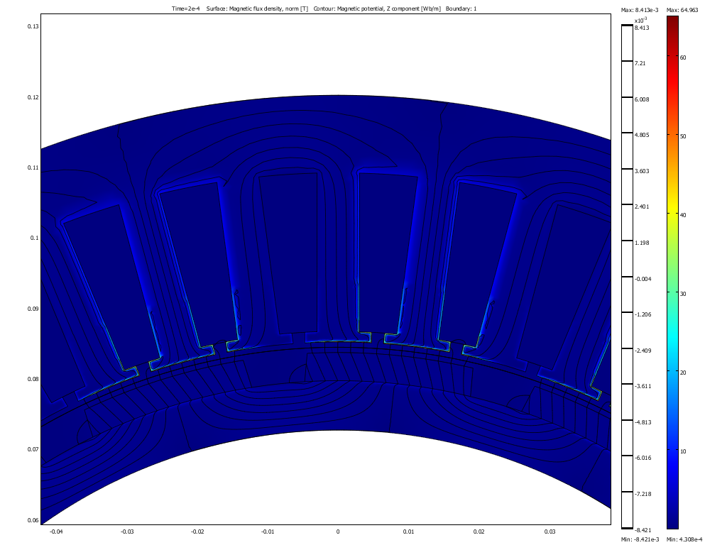

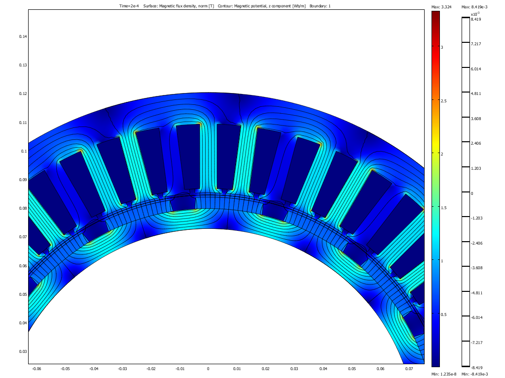

As now having acceptable magnetic flux densities my next step is to couple the model with heat ttransfer and get a temperature distribution caused by resistive heating. For this I have to specify conductivity. Doing so my results become unusable having increasing flux densities with time. I attach hardcopies with sigma=2e6 [S/m] and with sigma=0 [S/m] for the rotor/stator. My mesh is believed to be fine enough and I used tolerances of 1e-5 for 'A'.
Resistive heating works, I have increasing temeratures, however, adding Sigma to the material ruines my magnetic field. (I expect flux densities around 2 [T] instead of 64 [T]).
I see that you also implemented conductivity in your model. Did you faced the same problem? How did you solve it?
(I use mainly COMSOL 3.4 but I've built the same model also in 4.2 and got the same bad results.)
Thank you for your comments in advance!
