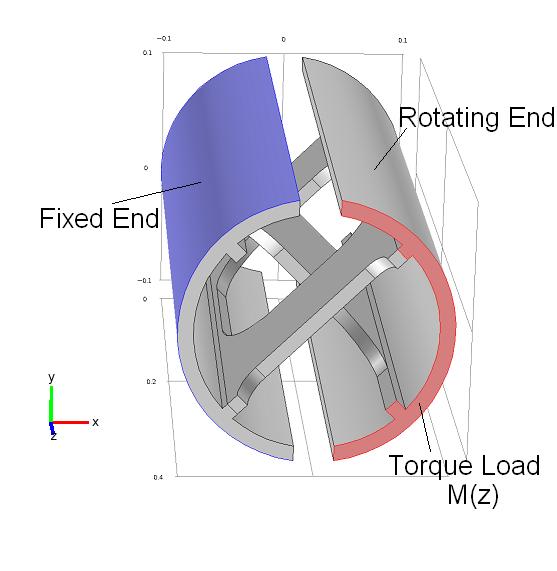

Hello everyone,
Could some one please take this model and apply a small torque load on one free end so that I know how to apply such loads?
the geometry is basically a rotating joint fixed on the outter side on one side and under torsional loading causeing the free end to rotate. pretty much like a single bar fixed at one end and under applied force from at the free end.
i have gone through all i could on the internet and that one toturial that Ivan recommends in comsol 3.5 but i just cant get it done.
Any helps or hints is appreciated, And I am really sorry that comsol simply does NOT provide enough litrature so that we dont have to creat a new thread for just every single problem. and while i am at it, the dynamic help is more like a bumper sticker than a real help!
Ali

Thanks for the hint Jean, but I just mentioned that because if you design a geometry in 2D you will have an option to define your boundary load directly in N.m dimensions, maybe i didn not address it right.
I did , however, got around the problem and I am posting it here for others with the same problem.
I defined stress parameters (Tx,Ty,Tz) in [Pa] and also a Radius (r=sqrt(x^2+y^2)) and included a time variable
(para=1-0.2*t) to fade my force out in 5 seconds of my analysis (Time dependant).
next i defined the boundary load as (Tax*y-Tay*x)*r*para. pay attention that the dimensions of this load is N.m.s but I am guessing it is a way of making it time dependant. the expression turned red when i entered it but i neglected that and moved on to the computation.
the results seem pretty logical and It simulates what I want perfectly. examining the reaction forces and displacement values also suggest that the solution is correct.
I should thank Ivan too, his posts are really helpful.
Thanks for the hint Jean, but I just mentioned that because if you design a geometry in 2D you will have an option to define your boundary load directly in N.m dimensions, maybe i didn not address it right. I did , however, got around the problem and I am posting it here for others with the same problem. I defined stress parameters (Tx,Ty,Tz) in [Pa] and also a Radius (r=sqrt(x^2+y^2)) and included a time variable (para=1-0.2*t) to fade my force out in 5 seconds of my analysis (Time dependant). next i defined the boundary load as (Tax*y-Tay*x)*r*para. pay attention that the dimensions of this load is N.m.s but I am guessing it is a way of making it time dependant. the expression turned red when i entered it but i neglected that and moved on to the computation. the results seem pretty logical and It simulates what I want perfectly. examining the reaction forces and displacement values also suggest that the solution is correct. I should thank Ivan too, his posts are really helpful.
