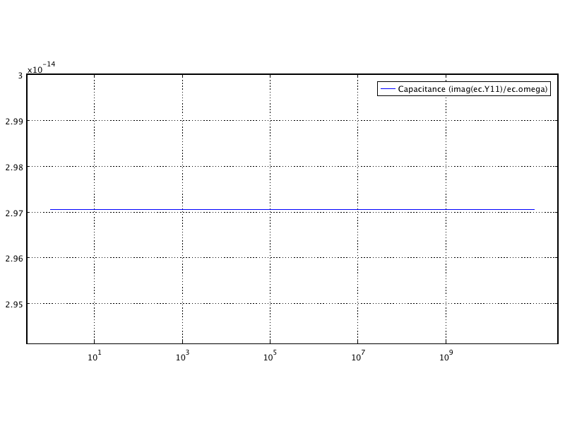

I was able to simulate my capacitor in a time-harmonic analysis in version v3.5a. Calculating the capacitance with the formula given in the microstrip example (C11=imag(Y11)/omega) gives me always the same capacitance, no matter what frequency I apply at the input port. I checked the input signal by drawing it versus the time, so I really see a sinusoidal signal with the desired frequency. This can't be correct, since the capacitance is frequency-dependent. Btw, I went up to 1 GHz.

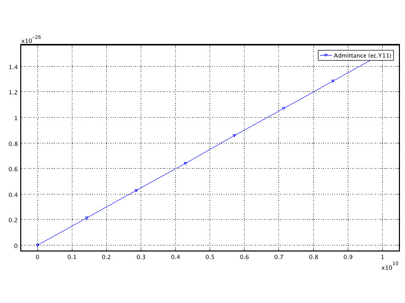

Then I tried a frequency domain analysis in v4.0a. Again, I simulated up to 1GHz and I calculated the Capacitance with the same formula. Again, I get a frequency-independent capacitance which can't be correct. I plotted the Admittance Y11 which shows a perfectly linear increase with the frequency, but I would expect something else due to fringing fields etc.
So to summarize: No matter if I try a DC analysis, a time-harmonic analysis or a frequency domain analysis, I always get the same capacitance, no matter which frequency I apply at the input port.

You're absolutely right, I also noticed that the Capacitance seems to stay very constant in lower frequencies but I guess this is just a question of resolution. I guess if you zoom in and adjust the axis scaling, the same plot would also show a quadratic increase in the lower frequency region, although its not that big. In my case, a have a perfectly constant value. Besides, I ran the simulation up to 100GHz yesterday and still did not see a difference.

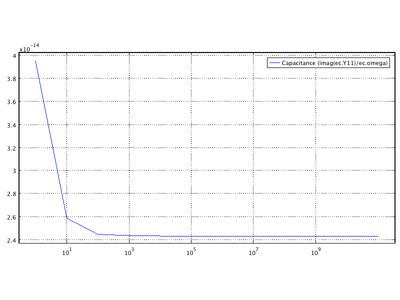

So I had the same idea and what I did was, I simulated the capacitor (14 microns high) on a 100um pyrex substrate (epsilonr=6.4) with another 100um air box on top (epsilonr=1).
The result is almost the opposite from what I would expect, the capacitance gets smaller (see attachment). The frequency range was from 1Hz to 100GHz by going up with a factor of ten (1Hz, 10Hz, 100Hz, ...).
Pretty strange...
