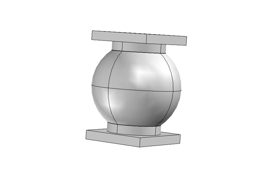

Posted: 1 decade ago 26 juil. 2011, 15:23 UTC+2
I met the same problem when I built the model for the microbumps. But my model is not complicated at all and the error still exist. Could you please have a look at my model in the attachment?
Many thanks
Mike
Hi, I met the same problem when I built the model for the microbumps. But my model is not complicated at all and the error still exist. Could you please have a look at my model in the attachment? Many thanks Mike
Posted: 1 decade ago 26 juil. 2011, 16:25 UTC+2
I solved my "out of memory during assembly"-problems by increasing my RAM to 72Gb. But in some case you could get some results when you change the solver settings. A good indicator of how much memory your simulation need is the display in the lower right.
To the model from Mike, I is not important how complicated your model might look. The real important value is the element size and the degrees of freedom your model has to fulfill. As an example, you could have an easy looking box but with enough physics into it your simulation becomes very large in memory.
