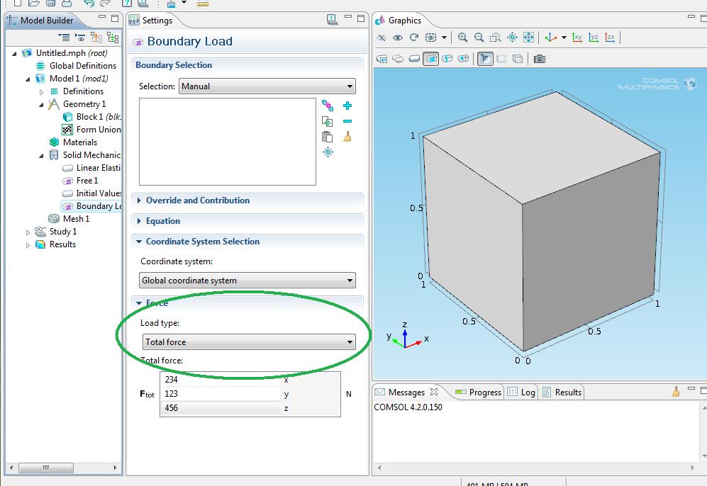

How can I input a total load on a boundary, without having to calculate the x-sectional area?
In many cases one knows the total force readily, and would simply like to impose a boundary condition of that force over that arbitrary area.
Frank

                                                    In v3.5a, you can have the software compute the surface area for you by way of an integration coupling variable. It's a bit clunky, but it works.
In v4.2, you have the option of providing the total force and the software does the rest for you, see screen shot.
