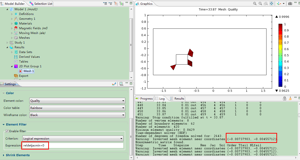

strange things about crazing inverted mesh warning
I searched the forum for my question, but not much clearly useful things.
just three quick question:
1). I tried to use logical expression to display the inverted mesh, and comsol find three element, but they not near the coordinate as warned in the log message. which should I believe? see the attached picture.
2). What wrong with these three element? they looks not inverted inside out.
3). If a model includes a ALE module, should the ALE module put first before other modules? Or the order doesn't matter?
4). I a prescribed a domain as " prescribed deformation domain" in the ALE module, then will comsol know that the boundary of this domain deforms with the domain together? Or an prescribed boundary deformation is required?
thanks! :)
