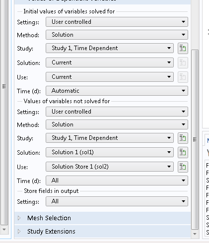

                                                Posted:
                                7 years ago
                                8 nov. 2018, 11:22 UTC−5
                                                    Dear Jeff,
Many thanks. So I attached my initial values set up for second sub-study (T). what you are saying is that even with this arrangement, I can still uncheck the v,p in the store solutions?
Regards, Asal
                            Dear Jeff,
Regards, Asal
