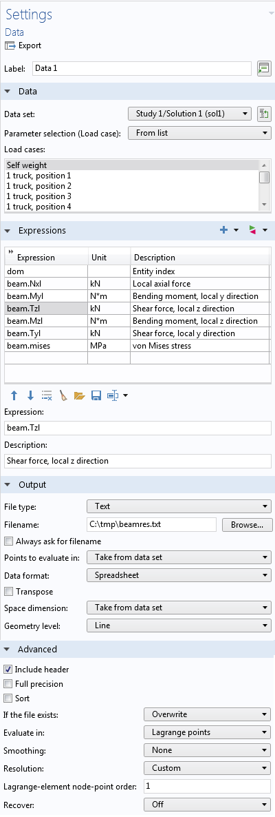

Hello all,
I am analyzing a truss structure using the Beam feature under Structural Mechanics Module. The study completed but I need individual stress values for each member in the truss. Is there any way that I can get a table that will show me the stress in each member? I have done a line maximum with all edges of the model selected. However, this only gives me the max stress of the entire model.
