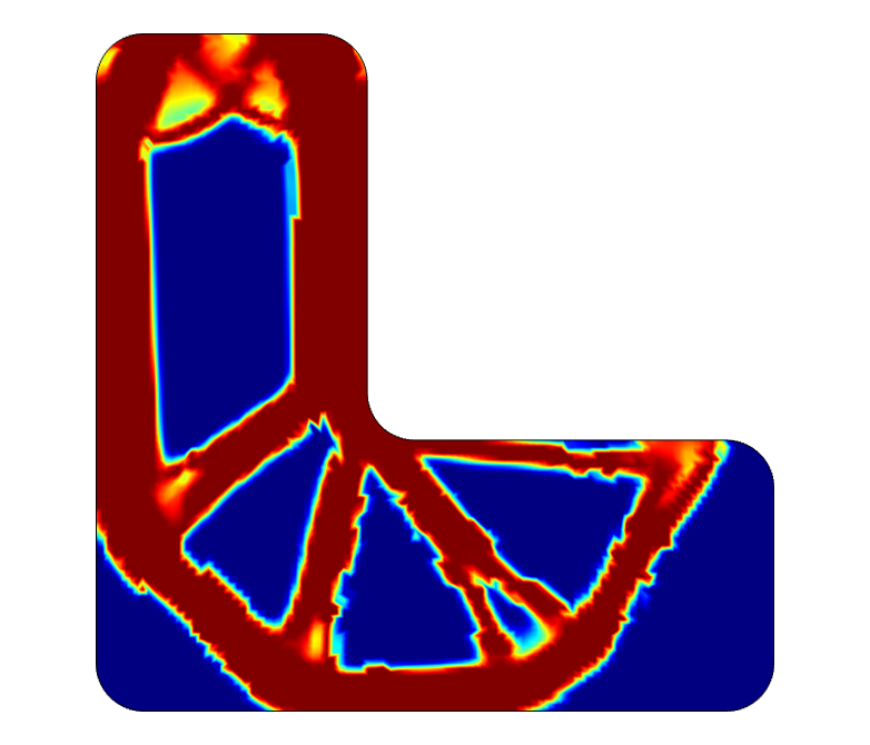

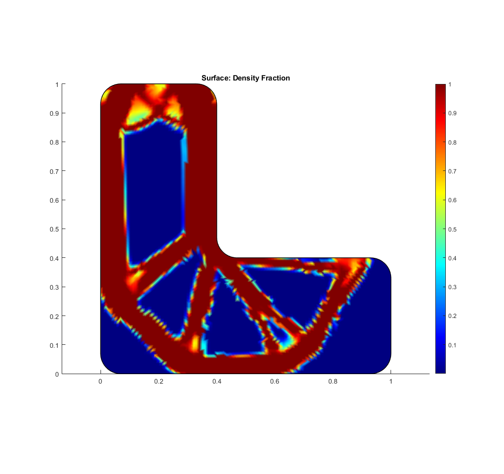

I have attached two pngs, one through mphplot from Matlab, and the other one directly from Comsol Multiphysics. You can see the difference in the resolution of the image, it feels like mphplot dilutes the data before sending it to Matlab.
Your input is highly appreciated.

I tried your suggestion but no improvement. I discarded the importing the figure from COMSOL to MATLAB and simply did it directly in MATLAB and the results were much better.
Thanks again for your help.
