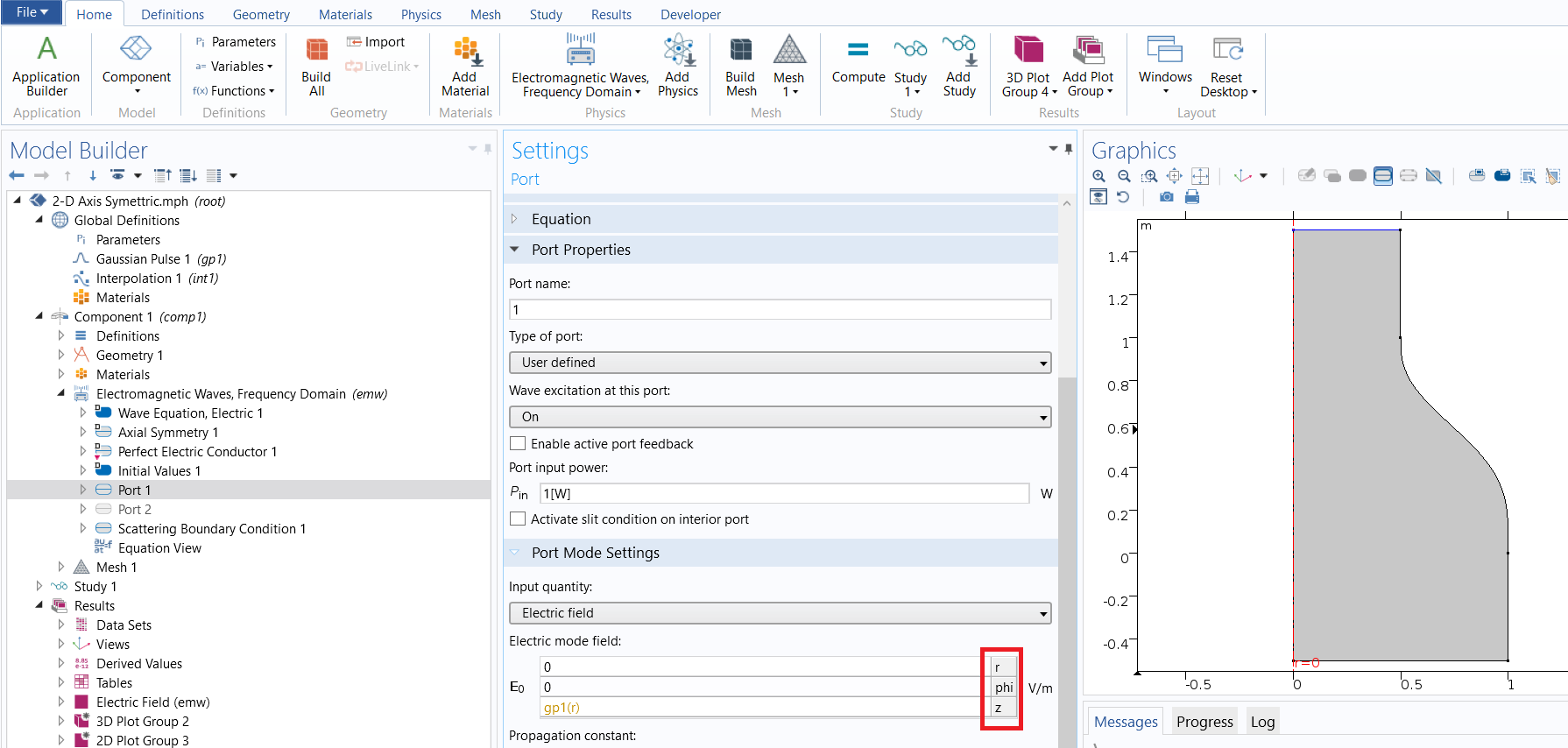

Defining Electric Field with X or Y polarization in 2-D axisymmetric case in RF (wave Optics) module
I was using the 2-D axisymmetric electromagnetic module to simulate a 3-D case. I can see that all fields are defined as Er, Ephi, Ez in this axisymmetric case in both "port" and "electric field". I want to define a wave with y polarization or x polarization. How can I do that? Also, clearly I can not express my desired x or y polarization base on R and Phi components since it involves sin(phi) and cos(phi) which are not recognizable by this module.
Thanks in advance

First of all, it sounds to me like you might be better off using a different representation (such as 3D). The 2-D axisymmetric model presupposes that your problem has 2-D axisymmetry; a plane wave does not directly exhibit that symmetry. That said, there can be extensions employed that, in some cases, will still allow you to do limited work in the 2-D axi-sym mode while using field distributions that do not exhibit that symmetry! But you will have to be very careful to do the math properly. For a very good example of how this can be accomplished, see the "conical horn lens antennna" in the Comsol-supplied application library, for the RF module.
