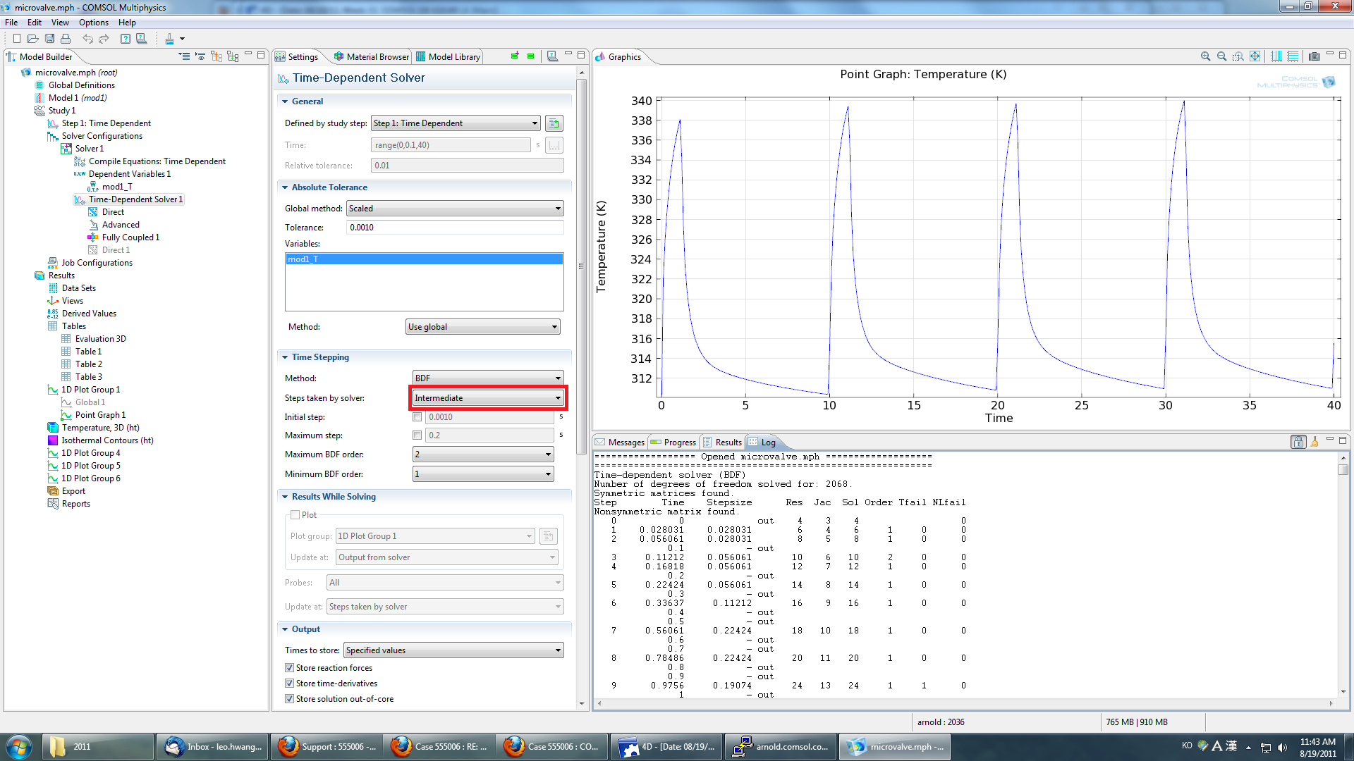

Been reading through the discussions and figured out how to build a square pulse and then repeat it with an analytic function.
Now I am trying to apply my analytic function to a heat source so that the heat source turns on and off like the analytic func.
rect1>>
lower limit: 0.0001
upper limit: 1.1
transition zone: 0.05
an1>>
expression: rect1(mod(t[1/s],10))
arguments: t
plot parameters: argument-t, lower limit-0, upper limit 39
^^^all this above works. I plot the function and it give me 4 pulses of the correct duration
PROBLEM:
Heat source: Qheater*an1(t[1/s])
^^^^ this only produces one pulse when i compute the solution
I'm sure I'm missing something simple
Any help please?
