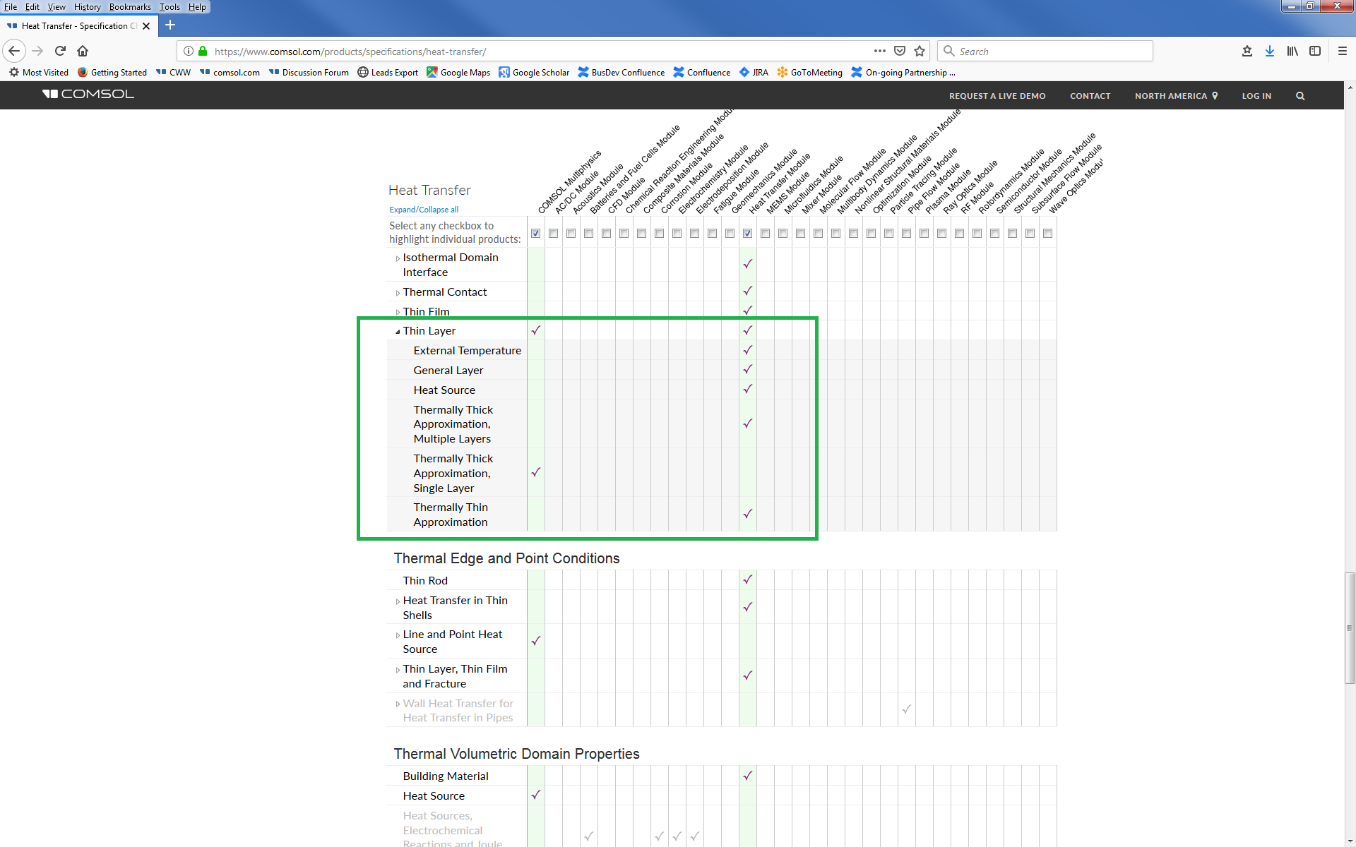

In the 'Heat Transfer in Solid (ht)' physics node that I have there is still a 'Thin Layer' option, how is this different to what is offered in the module?
(I'm guessing that it can only do a 'thermally thick approximation' of a thermal boundary resistance...?)

Posted: 7 years ago 19 déc. 2018, 08:36 UTC−5
The attached screenshot (from the "Specification Chart" on our website) compares what's in the core package vs the Heat Transfer Module as far as Thin Layers on boundaries.
Contact your COMSOL rep for a trial of the Heat Transfer Module: www.comsol.com/contact.
The attached screenshot (from the "Specification Chart" on our website) compares what's in the core package vs the Heat Transfer Module as far as Thin Layers on boundaries. Contact your COMSOL rep for a trial of the Heat Transfer Module: www.comsol.com/contact. Jeff
