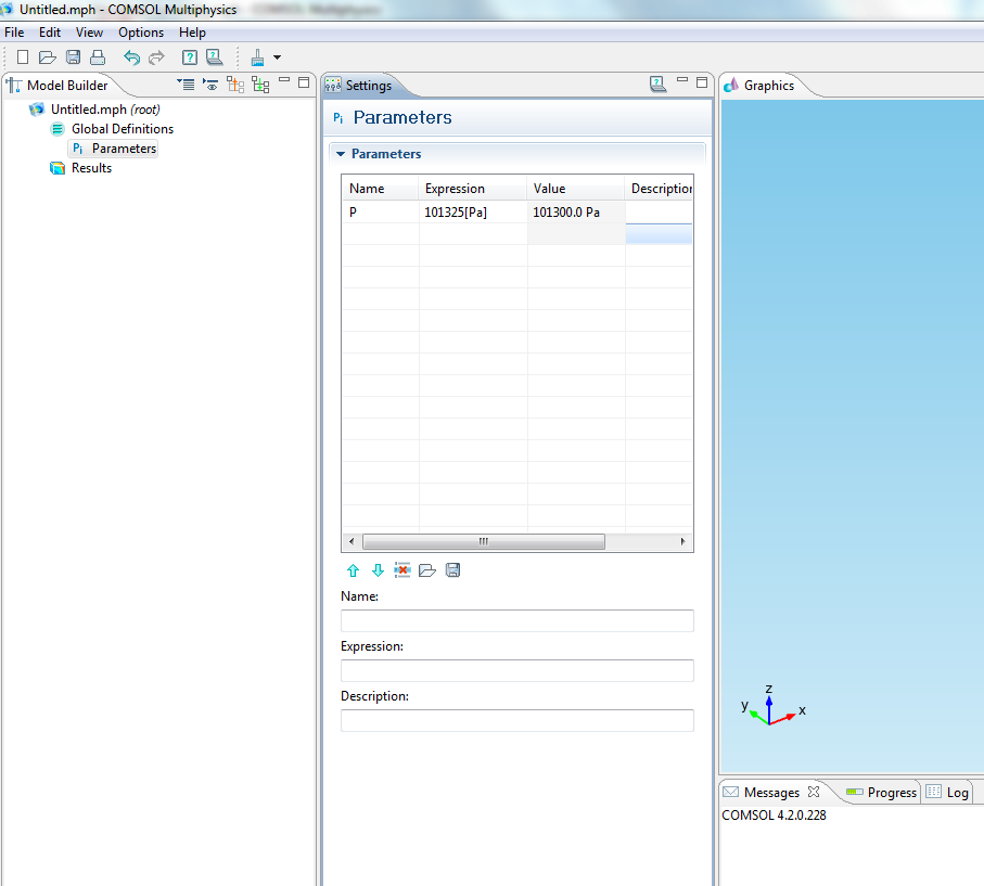

Hello everyone,
plz have a look attached image file..I have typed pressure value as 101325[Pa], but comsol considering it as 101300...
any clue? you can try this on comsol..

The input display precision can be adjusted in the Options>Preferences menu. By default, it's set to 4 digits.
