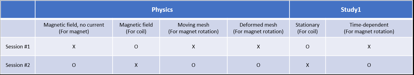

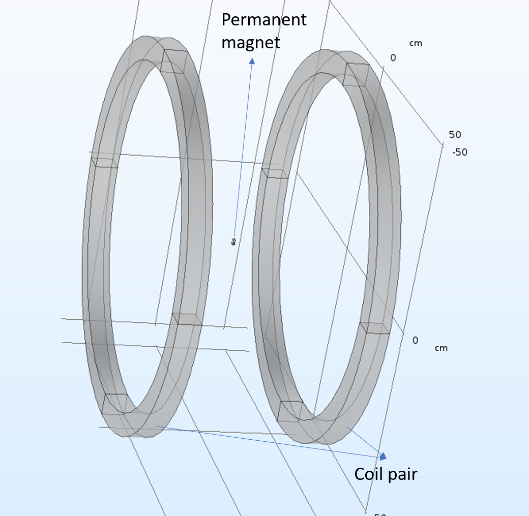

Basically, I am trying to find an magnetic interaction between 'rotating permanent magnet' in the magnetic field which is genereated by 'a pair of multi-turn coil' [Pic 1].
By the way, I had a problem with computing both 'time-dependent' and 'stationary study' at together. Below are what I tried but failed.

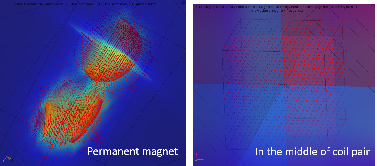

Independently computing 'time-dependent' and 'stationary study' one by one. ->Each result was established without error but not interacted. The magnetic field from magnet and coil is not mixed but independtly existed. [Pic 2, Pic 3]

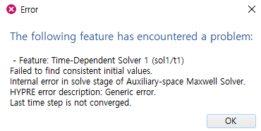

Processing all physics only with Time-dependent study ->Error: Failed to finding Initial vaue and Internal error [Pic 4]

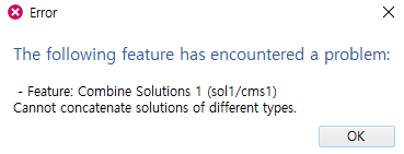

Right click 'study(time-dependent)' and tried 'Combined solution' ->Error: Cannot concatenate different types[Pic 5]

For a time dependent problem it can be useful to do a stationary study step and then take the stationary solution as an initial value for the time dependent step. But you have to take care that the time dependent situation at t=0 approximates the stationary situation. E.g. in a rotating system calculating stationary without rotation and then start the rotation at full speed may not work. You need to ramp up the speed from zero. Just an example, your problem may be different.
You cannot combine a stationary and a time dependent solution. As said before stationary can be a good initial value for time dependent.
Cheers Edgar

I think it is possible to combine a stationary solution with a transient solution within a for-loop.
For this you have to divide your transient problem into (nmax-1) time periods and you repeat a for loop (-> solution -> programming) nmax times.
At first (before the loop starts) you have to compile the quations and to set the initial values (Dependent variables). Then the for loop starts. The work flow is as follows:
  • compile equations
  • dependent variables (set initial values)
  • For (begin)
    • compile equations
    • dependent variables (set initial values to current)
    • instationary solver
    • compile equations
    • stationary solver
  • end for
What we need is the for-loop counter to recalculate the time (start, end) for the transient solver. This is currentiter, using this varable you can recalculate the correct time.
You have to take care, that the transient solution runs using the stationary solution.
