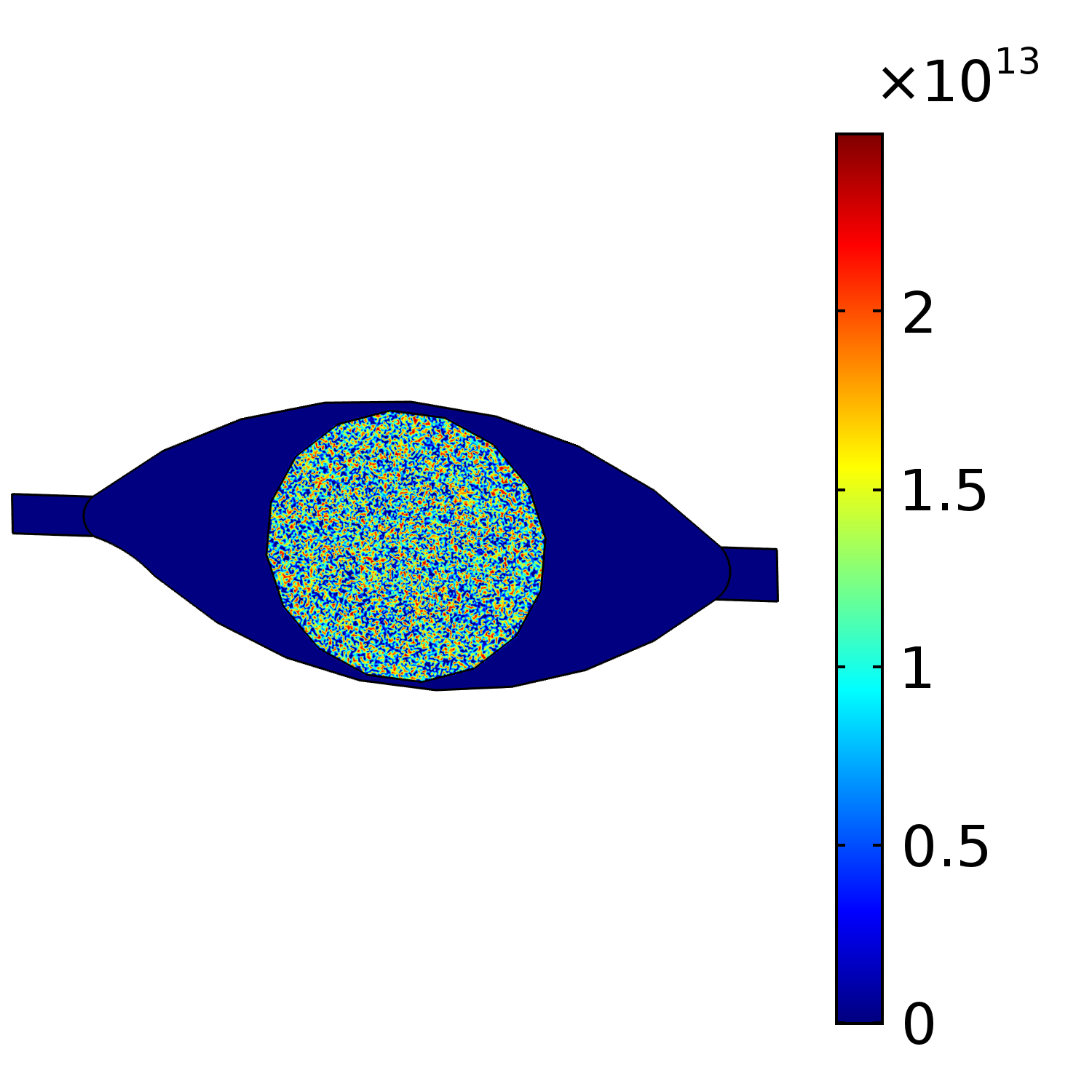

I want to model the development of biofilm in a perfusion culture. I model the cell culture chamber as a 2D transport of diluted species. I therefore want an initial concentration in the cell culture chamber to be random or non-homogenous. I have tried using the random function which is good but it fluctuates too much over small distances (too many peaks in small area). I alternatively tried to add a sinecurve multiplied by the initial concentration of cells, but with no avail. Is there a way to achieve non-homogenous initial condition which is smoother than what the random function can achieve? I know i can define spots around the cell chamber manually and apply an initial condition to these independently, but i shope for a better solution.
I have included an image of the initial cell concentration using the random function.

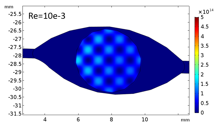

Thanks alot for your reply Jeff, and sorry for the long delay. For anyone looking this up later, i did find my issue. Because my model was i only a few mm scale, my sine-cosine wave was too large to give an impact on my initial concentrations. Increasing the frequency of the sine-cosine plane with around 10^3 fixed my problem. My initial condition thus ended up being Cx0+Cx0sin(1000x)cos(1000y), resulting in a good nonhomogenous initial condition. I have included an image for anyone looking this up in the future.
Hi Jeff Thanks alot for your reply Jeff, and sorry for the long delay. For anyone looking this up later, i did find my issue. Because my model was i only a few mm scale, my sine-cosine wave was too large to give an impact on my initial concentrations. Increasing the frequency of the sine-cosine plane with around 10^3 fixed my problem. My initial condition thus ended up being Cx0+Cx0*sin(1000x)*cos(1000y), resulting in a good nonhomogenous initial condition. I have included an image for anyone looking this up in the future.
