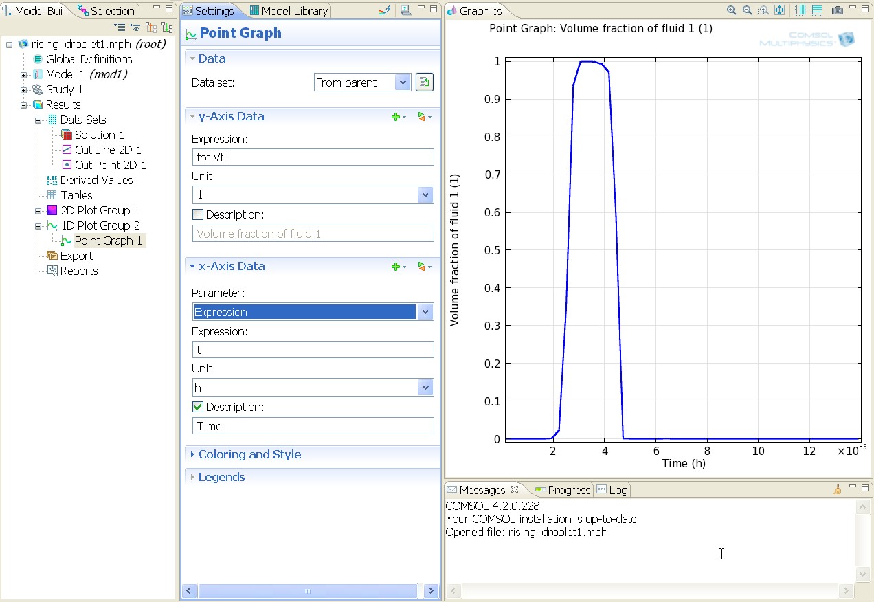

I hope that the attached picture answers your question.
Hi, I hope that the attached picture answers your question.

I suggest a simple solution.
Use the expression for time t/(24*60*60) for a day... and so on.
Change the axis label to day.
I suggest a simple solution. Use the expression for time t/(24*60*60) for a day... and so on. Change the axis label to day.
Posted: 1 decade ago 17 sept. 2011, 17:51 UTC+2
Thank you for your answers. I did with your way and got it well.
