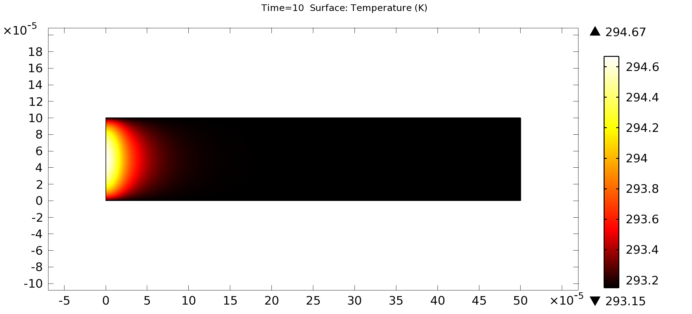

I have added a Heat Source in the Heat Transfer physics. My heat source is a Gaussian beam.
Q = (2*alpha*Po/(pi*r0^2))*exp(-2*(r/r0)^2)
I maintain temperature fixed on the walls of the cell using Temperature (T0=293K). (I have done this because the cell is placed in the thermostat). When I remove it, temperature becomes extremely high.
Velocity is also constant when changing the time.
p.s. I get a distribution of the temperature but it doesn't change with time. Temperature distribution is like a Gaussian distribution. find attached.

But you need to define a boundary with a constant temperature (or another heat sink) A constant T boundary means that COMSOl adapts the heat flux through this boundary to keep the Temperature constant hence to get an energy flux balanced. if no you have a perfectly isolated sytem, and then if you heat it , with time you will end up at a T=inf ;)
You can also hep debugging your model by plotting the heat fluxes or total energy (but note that you might have quite some discrepancies on heat flux integrations. See the doc
Another point, if you have solved the model a few times and updated it, COMSOL might have generated several Study DataBases and you are updating no 2 or 3 while your plot is pointing to the study 1

Where do you place the heat source? If your walls have constant temperature it is no surprise T does not vary with time, then it all depends on where you placed your source and how strong it is.

your simulated time span might be much longer or much shorter than the actual thermal response time scale of the system and this may be the reason why you don't see any noticeable change in temperatures over the time span & time resolution you are looking at in the simulation. Just a thought.
