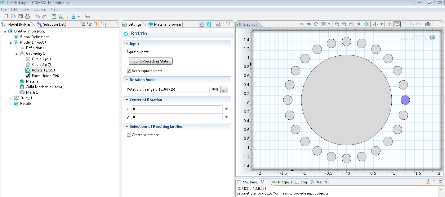

In V4 what if you try the "rotate command" on the small circle and define a "range" see the image
Hi In V4 what if you try the "rotate command" on the small circle and define a "range" see the image -- Good luck Ivar
Posted: 1 decade ago 27 sept. 2011, 13:56 UTC+2
Dear Ivar,
Thanks a lot. It worked.
