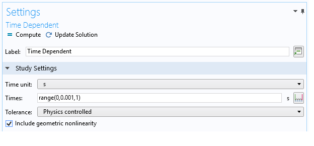

Hello everyone,
I'm trying to run a simulation using the livelink with MATLAB, but I'm having a problem. The thing is, I don't know how to write a code that activates the 'Include geometric nonlinearity' for a transient study in MATLAB. I've read the COMSOL manual, but I found nothing useful. I was wondering if anyone can help me with this.

The easist way if you do not know the API is to select the check box in the GUI and then do a Save As on .m format. The last line will then look something like
model.study('std1').feature('time').set('geometricNonlinearity', true);
Henrik

Hi, The easist way if you do not know the API is to select the check box in the GUI and then do a *Save As* on .m format. The last line will then look something like model.study('std1').feature('time').set('geometricNonlinearity', true); Regards, Henrik
