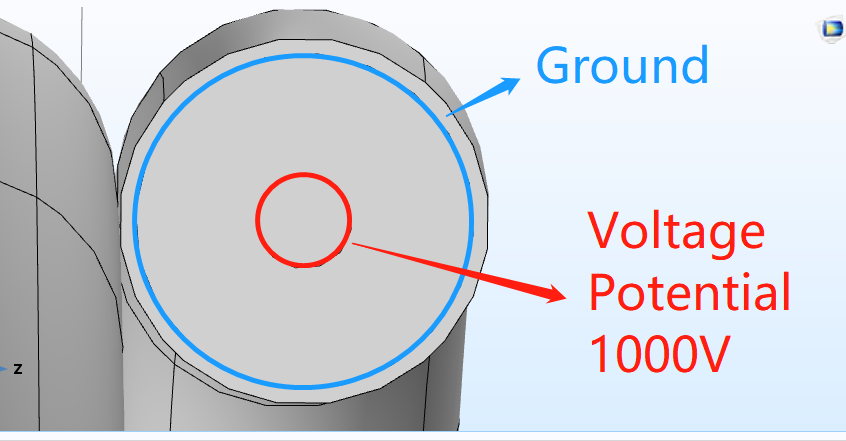

In my system, I want to do a electromechanical simulation. The image is the side view of the model. It is a core-shell-shell structure. The high voltage potential is applied on the edges of the core. And use fixed constraint for one end of the Helix. Could you please try to do a simulation of this structure? I find mesh is very difficult for this structure. I use swept for mesh if there isn't an additional helix for soldering. However, if we add the additional helix, it shows me a lot of errors. So, how to solve this problem?

Yes you need to set up a user controlled mesh for that. But I think this can be done. It was meant to be a hint. I won't be able to afford more time for the detail work on this.
Good luck Edgar
