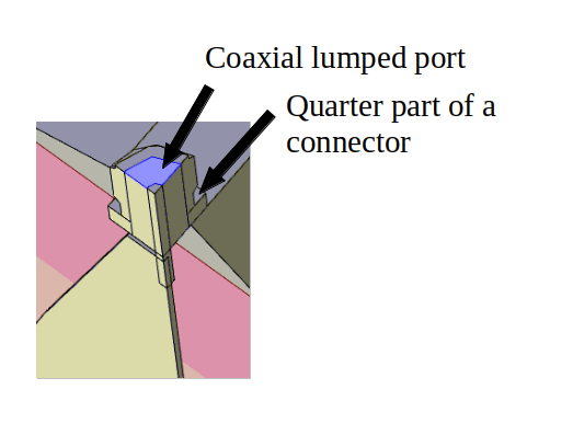

Hi all,
I am simulating a TEM (Transverse electromagnetic) cell. The geometry have two PMC (Perfect Magnetic Conductor) symmetry planes, so I simulate only the quarter of the geometry. The two planes of symmetry bisects the coaxial lumped port, then I adjust the settings by multipling the impedance by for 4. I have strange results so I think I am not doing it in the right way. My question is how to define the coaxial lumped port . Should it be defined by user ? If yes how to specify 'h_port' 'w_port' and 'a_h' ?
Atatched a figure to explain more my question.
Thank you for your help, Emna

Interesting question, so I just played with this a bit. My suggestion is to not even bother with a LUMPED port, in this case. Consider using a "coaxial port." (Boundaries --> Port --> Coaxial). Yes, I know, but it's only a quarter of a coax, right? Well, despite the fact that your port is not the full pair of concentric circles, Comsol Multiphysics seems to understand that it is a legitimate coaxial port (aka, a coaxial RF port) presumably based on the existence of the PMCs and concentric circular arcs. I was actually (and pleasantly) surprised it understood my specification from that perspective, but it did. Anyway, via this approach, it looks as if you can proceed much as if you had started with the full model, and then extract S11, VSWR, etc.

Thank you very much for your prompt reply. I used a "coaxial port" instead of "lumped port" but I got this error message 'the slit condition should be applied only on an interior boundary or the port should be placed on an exterior boundary' so I activate the slit condition. I don't get any error message anymore but the results are false. Is there anything else to do when dealing with ports instead of lumped ports ?

Your port should be on an external boundary. (It is, right?) Make sure that the boundaries (edges) of your port are conductors on the curves and PMCs on the radii. It works for me. See attached example,

Thank you so much for your help and for you example ! Yes my port is on an external bounday and normally I defined it as you did in your example but I still have error message. I can't figure out the fault in my model. I have attached my mph-file and my geometry .xt (imported in the mph-file in the hope that you see the error and can help me.

I took a quick look at your file. It seems to me that your ports are NOT external boundaries. They are boundaries of solid dielectrics, but there is air on the other side. An exterrnal boundary is a boundary on the external surface of the model. Air, or any other material domain that gets meshed and has FE fields computed in it, is part of the internal part of the problem.
Although there may be an easier way to proceed, what I normally do if I want to have an "external" port but at the same time I want air or other materials very near/around it, I add (actually, I subtract from the local volume) a small volume that is right up against the port, thus creating a truly "external" surface on the actual port. (This little volume is not to be meshed, and not part of the computational space.)
