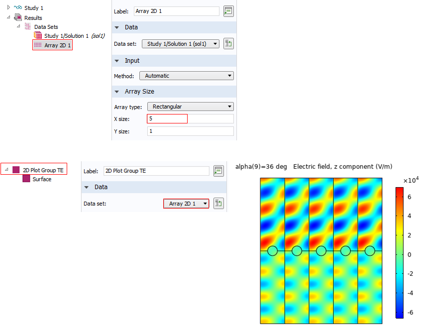

To plot many periodic cells, create Array data set and the reference to this set in a Plot Group, as shown in the attached image.

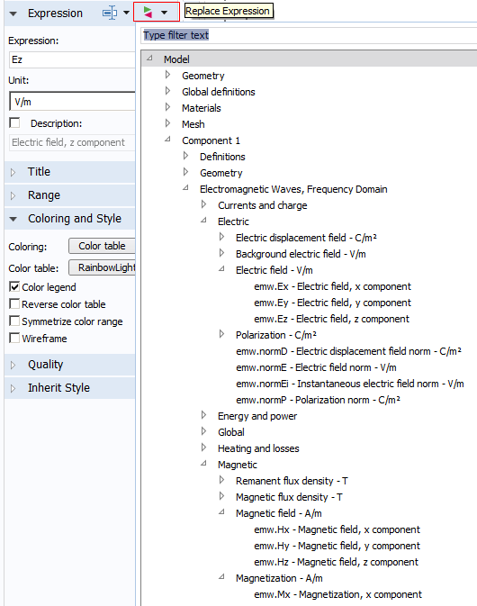

There a lot of predefined variables - you can use Equation View or Replace Expression option to see the list of predefined variables.
Sergei
Jorge, To plot many periodic cells, create Array data set and the reference to this set in a Plot Group, as shown in the attached image. There a lot of predefined variables - you can use Equation View or Replace Expression option to see the list of predefined variables. Regards, Sergei

I did manage to create an Array data set and plot it, thank you.

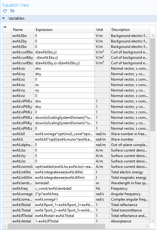

On the other hand, I did not find the "Replace Expression" feature. I enabled "Equation View" where it shows variables like "Surface current density, x component" (see figure eq_view.png) but don't know how to plot it as a function of x for example.
How can one see all functions COMSOL had by default and is there a tutorial about the syntax used by COMSOL to insert new functions?
Regards, Jorge
I did manage to create an Array data set and plot it, thank you. On the other hand, I did not find the "Replace Expression" feature. I enabled "Equation View" where it shows variables like "Surface current density, x component" (see figure eq_view.png) but don't know how to plot it as a function of x for example. How can one see all functions COMSOL had by default and is there a tutorial about the syntax used by COMSOL to insert new functions? Regards, Jorge
