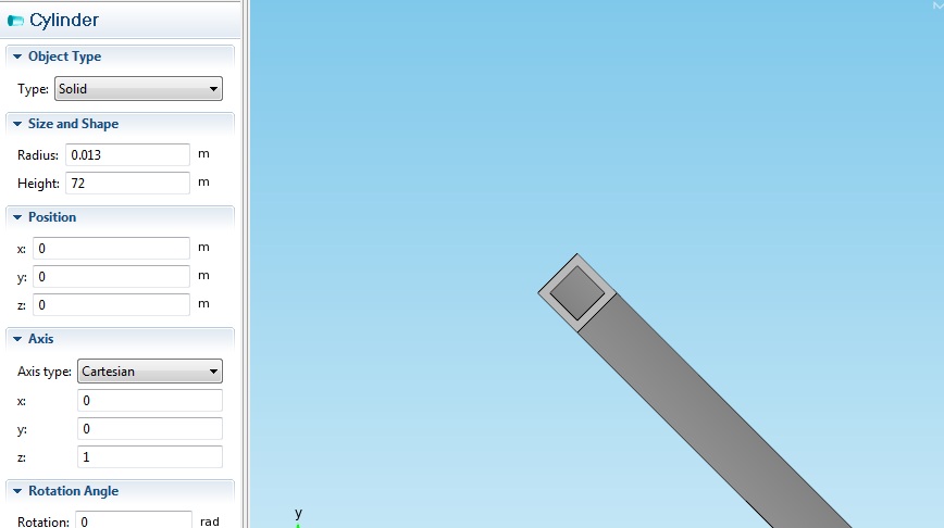

Im using 3d view and comsol 4.2. In attach is a print screen of my tube.
I saw that if I use a lager radius of the tube the cilinder take your real form, but for small radius its a rectangle.
Im using 3d view and comsol 4.2. In attach is a print screen of my tube. I saw that if I use a lager radius of the tube the cilinder take your real form, but for small radius its a rectangle.

Your cylinder has a very high aspect ratio. COMSOL by default does not accurately plot very small lines/surfaces (a very suitable setting for speeding up most 3D plots). You can override that by setting Detail = Fine under the Options menu > Preferences > Graphics. You may still run into trouble with meshing and analysis. If this is a solid consider defining a line instead and using beam elements.
