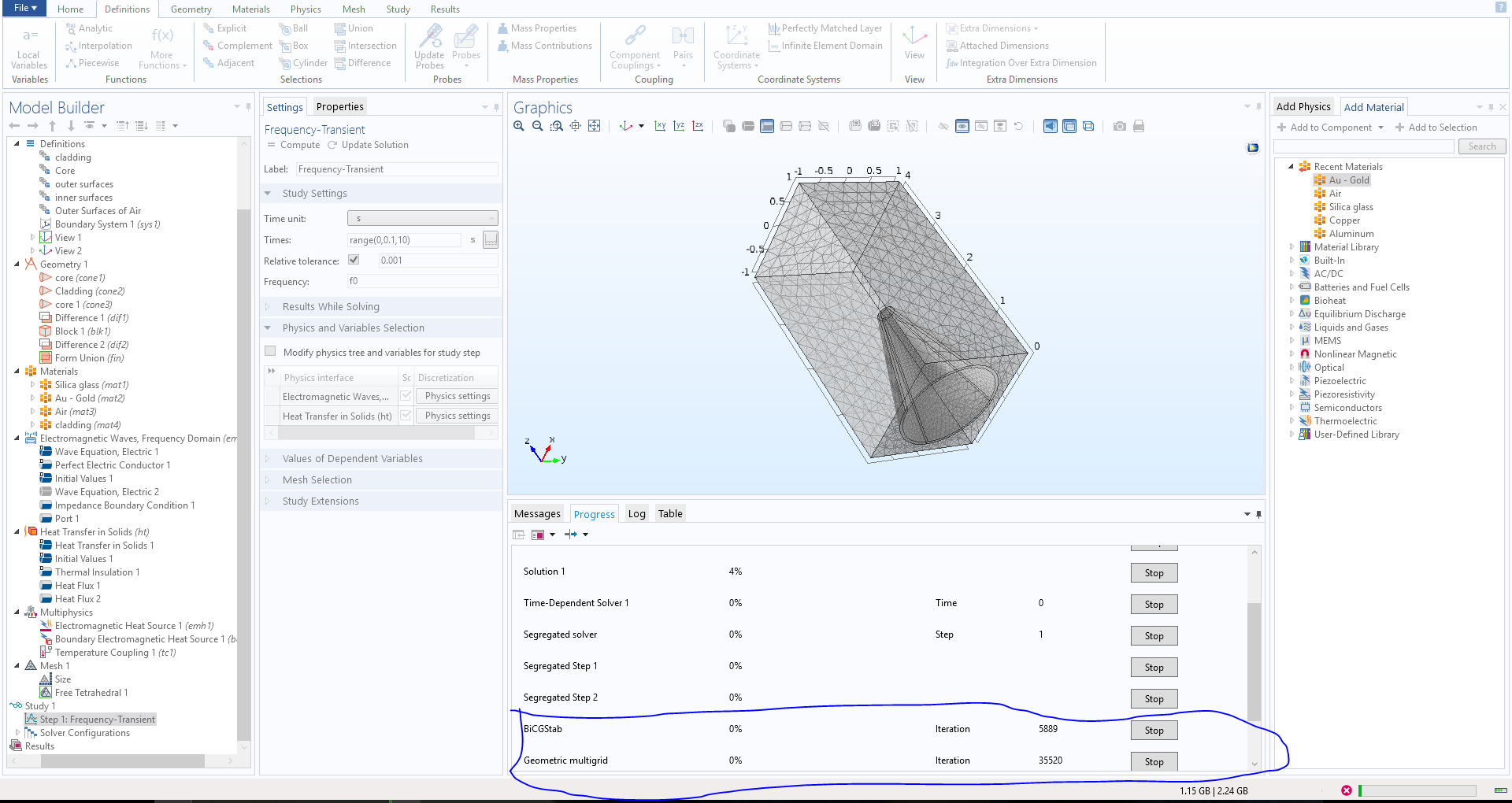

I have been trying to simulate microwave heating for a model that I made using COMSOL 5.2. The problem I am facing is that the simulation is stuck at iteration of geometric multigrid and BiCStab. It has not even started ploting the convergence graph for the simulation after hours of simulation. I am attaching a screenshot to show the situation. Please help me out here.

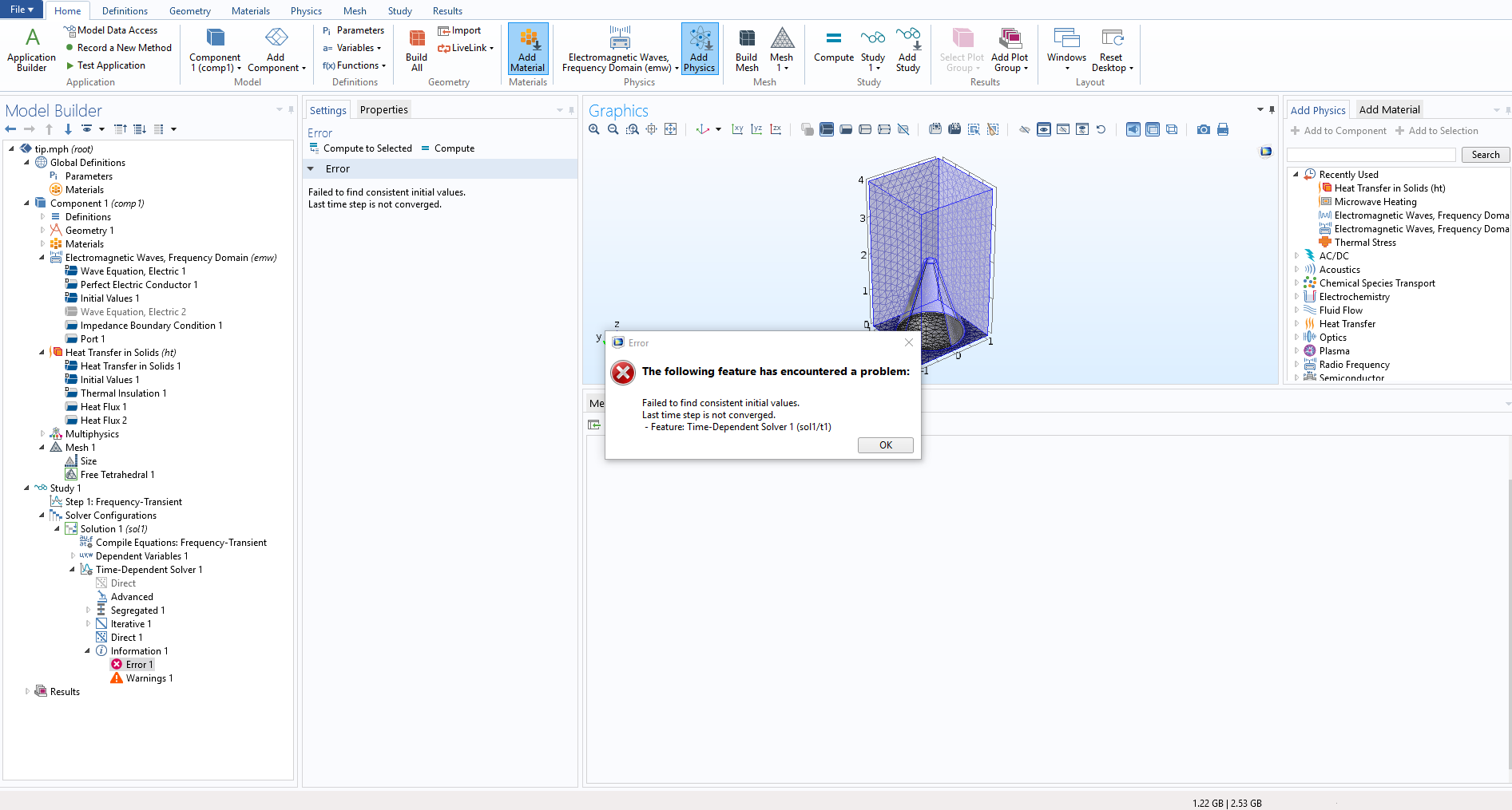

I refined the mesh and still got this error
