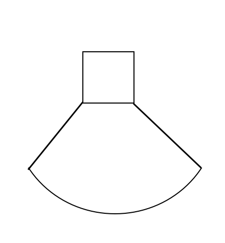

I am trying to draw a 3D chamber coming from a rectangular channel. The 3D chamber would be an extrusion of an arc of a circle as in the picture file shown below. I am kind of clueless to even know how to start drawing the arc in a separate work plane from the rectangular channel. Any help is appreciated.

I would try to draw a circle and a triangle/trapeze and intersect both, then add the square, and extrude, eitheras one or in two steps, all depends what you are after
Hi I would try to draw a circle and a triangle/trapeze and intersect both, then add the square, and extrude, eitheras one or in two steps, all depends what you are after -- Good luck Ivar
