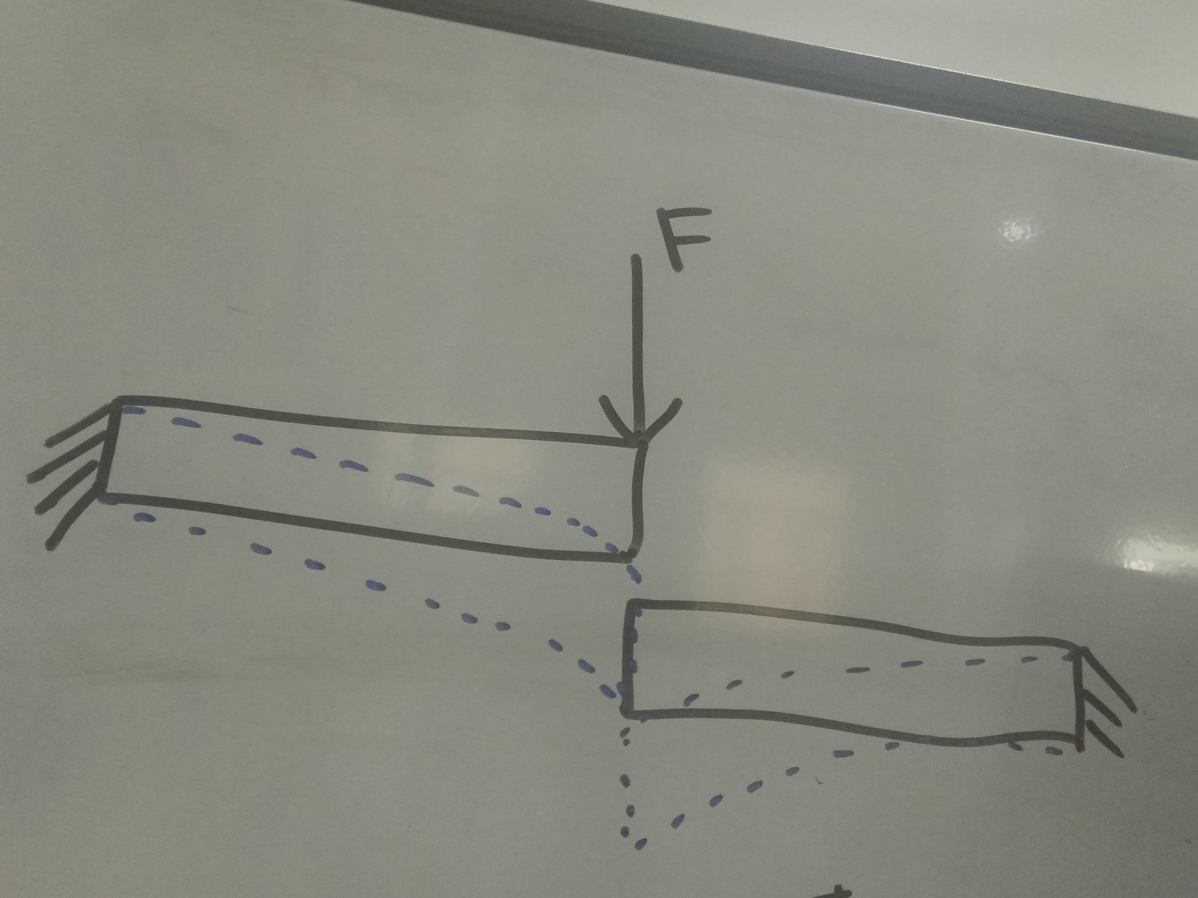

Hello Jello,
Thanks for your suggestion. I am getting an error in comsol that "failed to find a solution. Maximum number of Newton iterations reached. Returned solution is not converged. Not all parameter steps reached." Can you please suggest me how to resolve this issue.
Hello Jello,
Posted:
7 years ago
24 avr. 2019, 02:45 UTC−4
Hello Jeff,
I simulated the model but an error was coming like this "Feature: Stationary Solver 1 (sol2/s1) Failed to find a solution. Maximum number of dogleg iterations reached.
Returned solution is not converged. Not all parameter steps returned."
Can you suggest me. What I observed is when I increase the prescribed displacement more than the gap between two domains, it is not showing deflection in the second domain.
Hello Jeff,
