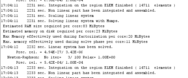

I'm interested in the intermediate steps too, to decide whether to kill the simulation or nor.
How can I save the log in an external accessible file?
Something like the attached image.
It would be great!
thanks
[QUOTE] By the way by default the logfile is deleted upon closing COMSOL, except if you say otherwise in the (Options Preferences) [...] you could also suggest to add the execution time to the log file, where it really belongs [/QUOTE] I'm interested in the intermediate steps too, to decide whether to kill the simulation or nor. How can I save the log in an external accessible file? Something like the attached image. It would be great! thanks
